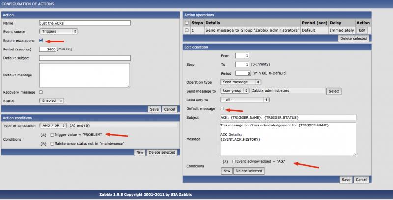

This would probably be in a macro. I looked and didn't see one for the new ack, but there is a {EVENT.ACK.HISTORY} macro that appears to print the ack history .. maybe that works for you
I try do like this. But mod files exist only for 2.0 version Zabbix. I try adapte modificated acknow.php file for my version of Zabbix, but it not work.
