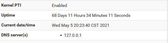

              • Augus.wang
                • Apr 2021
                I want to get the uptime from target network device (a pfsense host
