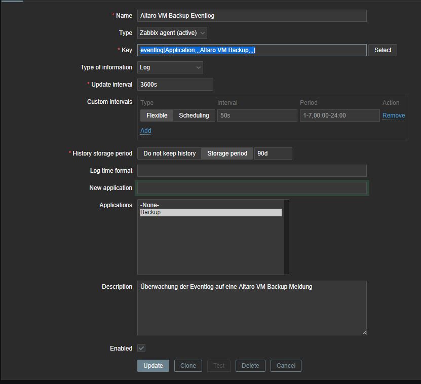

    i have upgraded my zabbix Server and proxies to the version 5.0.
    on the old agent with the 4.2 version the eventlog monitoring works fine.
    Now when i install new agents with the version 5.0 and assign the eventlog template to them it doesnt work. i dont get any data out of the agent even if i set the item to send me all data out of the eventlog.
    Also there is no error in the log files or in the zabbix frontend.
    i would be happy if someone could help

          • gofree
            • Dec 2017
            • 400
            Hi
            to me it seems that the item eventlog[System,,,,,,] works fine on the agent level
            if other active items on the agent are working ( ? ) Id go to zabbix-proxy log if you see this values in there too , after check zabbix-server log - the data should be visible all the way ( with increased log level ) on all componenets
            if they're not ( other active items ) double check the hostname in config file and zabbix gui ( anyway I guess you did that already )
              Check interval 3600s ...
              You did wait for one hour, I hope?
              Just checking......
