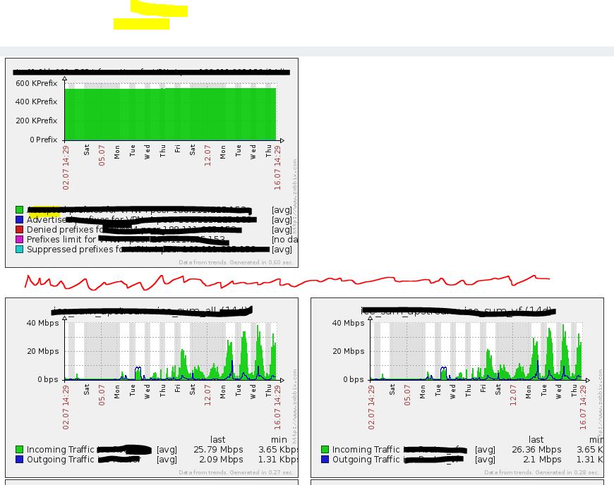

    Hi there,
    does anyone found a possibillity to insert some "free Text" fields in the Screen View to do some more structure in the Screen View.
    Something located at the Position between the Graphs (e.g. where the marked red line could be found)

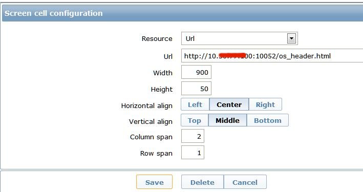

    I have asked Alexei in the past to consider doing exactly what you are asking about. To date, it has not been implemented.

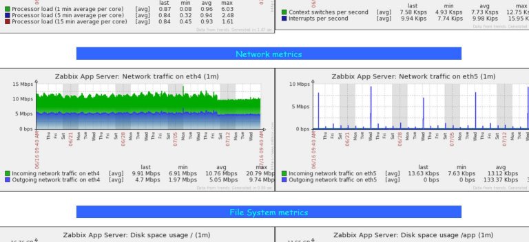

    So, the way I have done it is to use some HTML headers to split up my screens in categories to give users a little better visual of how I have them laid out.
    To achieve this I configure the screen cell as shown below. The final layout is shown is the screenshot of the screen at the bottom. I create the HTML files and place them in my /var/www/html/zabbix directory and give them the correct permissions for all users to read.
    It has been awhile since I have created those headers. I believe the trick to doing them was to create them in Excel and save them as HTML files.
