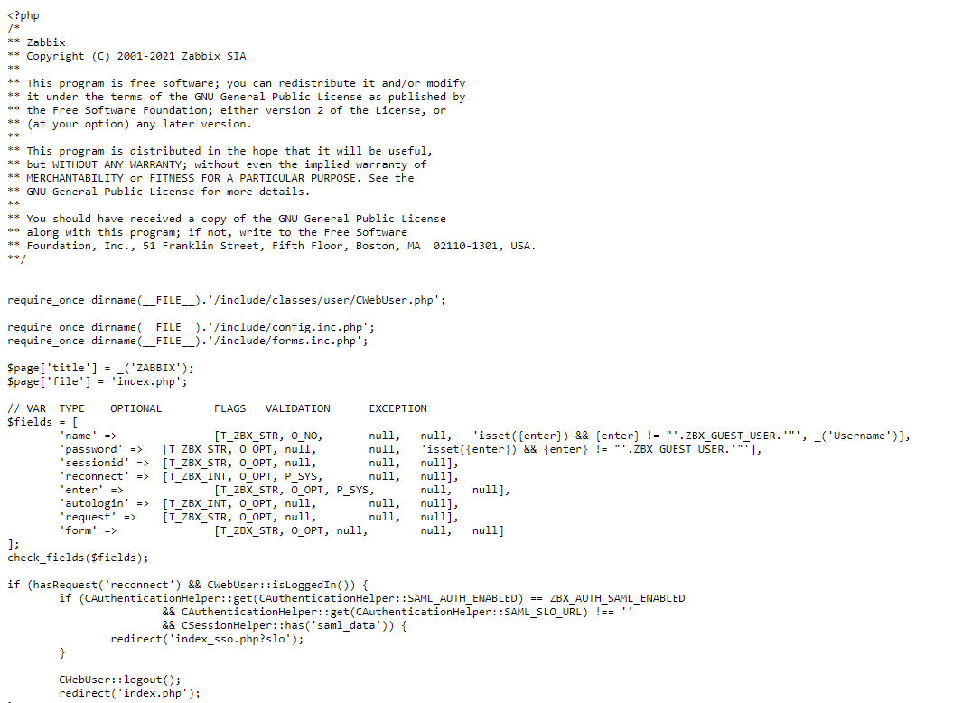

    I have installed Zabbix normally on my Ubuntu 20.04 machine and when trying access /zabbix I'm getting the attached output and not the normal log in page of the app.

    Hi, were you able to resolve your issue?
    I, currently, have the same problem.

      PHP isn't installed on the server.

        What version php are you running?
        I do have PHP installed. Installed versions are: 7.4, 8.0 and 8.1.

        PHP 7.2.24 (cli) (built: Oct 22 2019 08:28:36) ( NTS )

      I have similar issue last time when I install more than two version of PHP. I remove both and reinstall only single PHP. Then it working fine for me. I not sure this will help you out or not for your case.

        Thanks for the response, I have tried that on a previous install but did not work. My PHP is set to version 7.4, to my knowledge Zabbix does not support version 8.1. If you stumble on other possible solutions, please share.

      Well, I'm running on PHP 7.4.3.

        Is PHP enabled in Apache?
        ls -l /etc/apache2/mods-available
        ls -l /etc/apache2/mods-enabled
        sudo a2enmod php7.4 (or whatever was the module name available, if needed)

          It is solved, I missed some files that were not copied to the correct directory and apache server had an alias that needed to be removed. (Jip, I know, silly stuff.)
