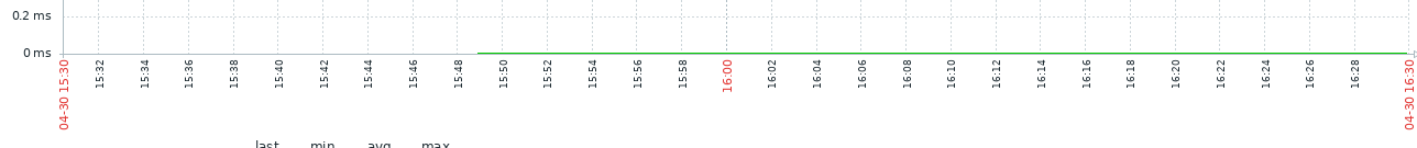

    What I did is a Item simplecheck with net.tcp.service.perf[ldap,{$OID.DEV.HOST},3060] type is Numeric(unsigned)
    The trigger is configured like {oid.dev.host:net.tcp.service[ldap,{$OID.DEV.HOST},3060].max(#3)}=0 which is copied from the out of the box template
    If I check the latest data then I this result: Click image for larger version  Name:	2021-04-30 16_31_01-BAMF E2E Montrng 5.2.4_ History [refreshed every 30 sec.].png Views:	0 Size:	8.8 KB ID:	423902
    Its always 0

    0 - serviceis down
    you are checking the ldap performance correctly, but use not integer - float.

      As you metioned I changed from unsigned to float. Unfortunately still getting value of 0.000000 .
