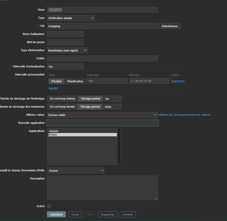

      I already read this part but that don't answer to my question.
      I just wan't to know if in the template ICMP Ping we can change or even see how much packets are sends.

          I read it and i saw the command: icmpping[<target>,<packets>,<interval>,<size>,<timeout>]
          but i work with icmp ping template like i show you with the two screenshots of my previous message and i don't touch anything in this template i just wan't to know if i can change something like the Key field ?

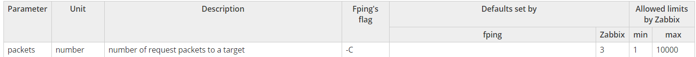

            I also saw the default number of packets who are send by zabbix serverClick image for larger version

            • fictitiousexistence
              • Jan 2026
              In your second picture in the 3rd field down is where you would put that command. Change 'icmpping' to something like 'icmpping[8.8.4.4,1,2000,32,2000]'.
              But it doesn't seem like you can modify that field in the default item for this.
              Instead you can create a new item.
              Click on your host, then on items and then Create item in the top right.
              Give it a name.
              Change type to Simple Check.
              Change Type of information to Numeric(float)
              In the 3rd field down named 'Key', enter the command icmpping[<target>,<packets>,<interval>,<size>,<timeout>,<op tions>]
              but change the fields to the values you want, like icmpping[8.8.4.4,1,2000,32,2000]

                To modify this at template level [because I think that's what the OPs question was], I would try changing the template key from icmpping to icmpping[,10] and see if that works.
