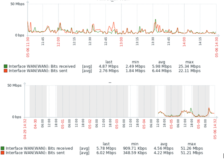

    Hello everybody!
    spent a lot of hours, but didn't found a solution ).
    I need to show some graphs in 2 different timelines:
    For example, internet-channel load for 1 hour and the same one for 1 week - .place them in one Screen (or two screens in one Slide-show)
    Ask you to help me in this issue )

    Ooooups!
    found necessery setting (time period) in Dashboard, so it can be a workaround for me:
    create needed Graphs in dashboard, include this Dashboard into the Screen.
    And than insert this Screen into the Slideshow )
    Ooooups again (
    It's impossible (?) to insert a Dashboard into the Screen...

      thank you Cyber!
      yes, I read that Screens will migrate to Dashboards.
      So I'll have to migrate to 5.4+ to have multiple-page Dashboards (currently in 5.2 there's not possible to make slideshow with Dashboards)

        Originally posted by splitek
        Will be really bad move to remove screens, without first adding replacement for them.
        I hope i will test 5.4 next week.
        The most idea is to display current situation on a wall-tv, with graphs of cource.
        As here - 1hour / 1 day / 1 week traffic:
          Screens will disappear in the future anyway, so try to manage with dashboard. If you just need to show 2 graphs side by side, I don't see any value of screen over dashboard...
            Well.. In my experience screen has never been more than a page with different graphs... Absolutely nothing, that I could not put on dashboard. But TBH maybe I have not used the functionality to the fullest..
            I think those templated "host screens" are already replaced with "host dashboard" in 5.2...
