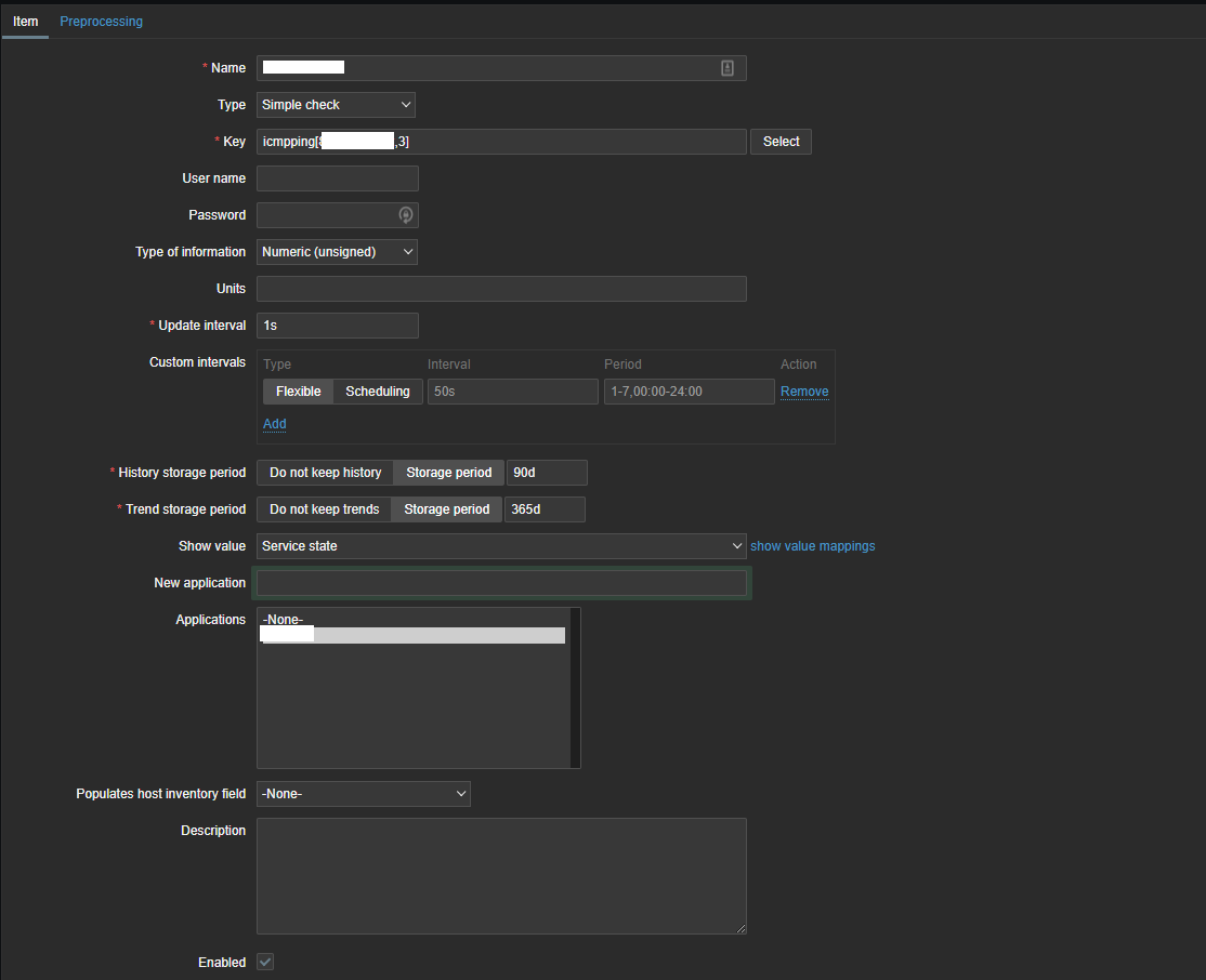

        For the record, I want to leave here how I achieved the ICMP Checks from zabbix.
        You have to choose as a Type Simple check and the key icmpping[<target>,<packets>,<interval>,<size>,<timeout>], but you don't need all those parameters... I am going with IP and packets only.
        Mine are like the screenshot, I just removed the IP address
          icmpping also takes parameters, you should use them. Specially "target"
          icmpping[,
