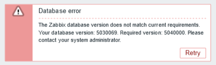

    Hi all.
    When I try to update my Zabbix from version 5.2 to version 5.4 (Installed on Ubuntu Server 18.04) I get an error message at the end, when I try to access via HTTP.
    There is also an error which appears in the logs of zabbix_server.log:
    sudo tail -f /var/log/zabbix/zabbix_server.log
    3526:20210520:073615.216 IPv6 support: YES
    3526:20210520:073615.216 TLS support: YES
    3526:20210520:073615.216 ******************************
    3526:20210520:073615.216 using configuration file: /etc/zabbix/zabbix_server.conf
    3526:20210520:073615.223 Unsupported DB! MariaDB version is 50505 which is smaller than minimum of 100037
    3526:20210520:073615.224 current database version (mandatory/optional): 05030069/05030069
    3526:20210520:073615.224 required mandatory version: 05040000
    3526:20210520:073615.224 starting automatic database upgrade
    3526:20210520:073615.224 [Z3005] query failed: [1832] Cannot change column 'scriptid': used in a foreign key constraint 'c_opcommand_2' [alter table opcommand modify `scriptid` bigint unsigned not null]
    3526:20210520:073615.224 database upgrade failed

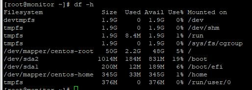

                  Well they changed the instructions. Install a new zabbix server. In centos 7 with zabbix 5.0.12 and mysql Version 15.1 Distrib 10.4.19-MariaDB.
                  Centos install it with a 400 GB disk and the disk distribution is like image 001 atach here.
                  My question is the following, how to know if the mysql DB will save the data in the partition with the most available space, which is the 345GB?
                  I ask it so that when the DB grows it does so in that partition that has more space available.
                  Thank you very much for answering and for your help Derli. An sorry for my bad. And I'm sorry for my bad English, but I'm from Chile and I don't write English very well.
