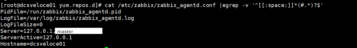

    2. agentd.conf settings
    [root@dcsveloce01 yum.repos.d]# cat /etc/zabbix/zabbix_agentd.conf |egrep -v '^[[:space:]]*(#.*)?$'
    PidFile=/run/zabbix/zabbix_agentd.pid
    LogFile=/var/log/zabbix/zabbix_agentd.log
    LogFileSize=0
    Server=127.0.0.1, <server_ip>
    ServerActive=127.0.0.1
    Hostname=dcsveloce01

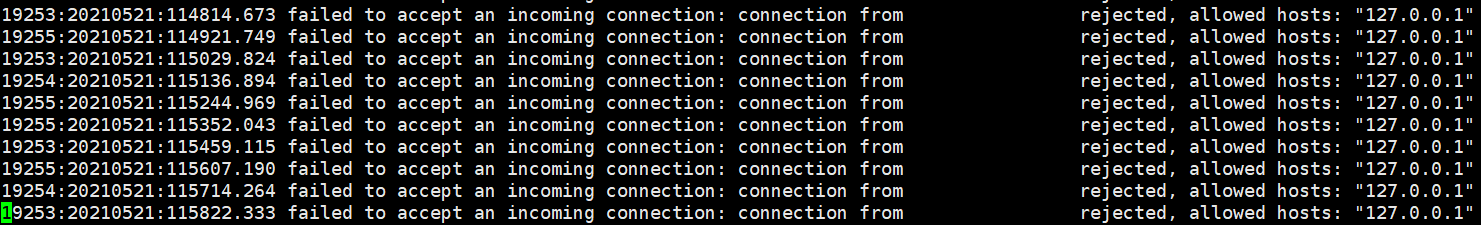

    3. zabbixlog status

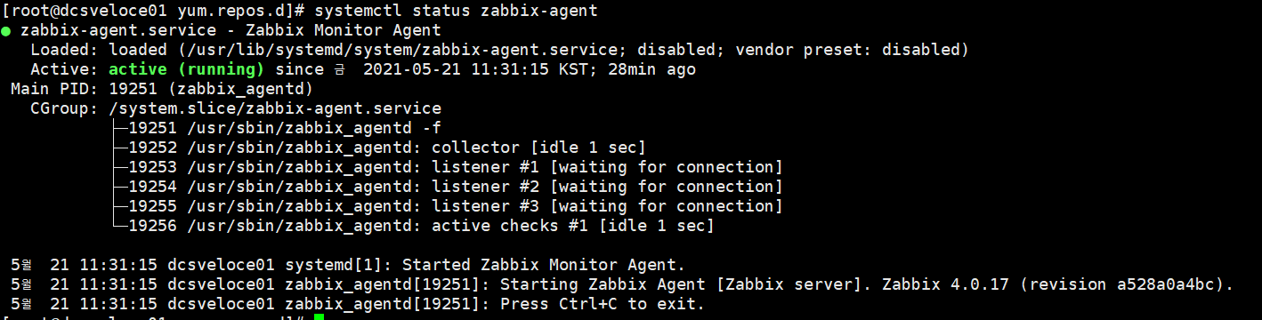

    4. zabbix agent status

    If it is not the Zabbix agent setting on Zabbix server, the Server and ServerActive settings in zabbix_agentd.conf are incorrect. Please specify the IP address of Zabbix server for both settings.
    • sanq
      sanq commented
      i added ServerActive=<zabbix_server_ip>
      and it works....
