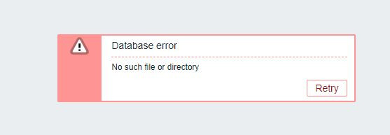

          Hello all
          I need your help. Please.
          Install a new zabbix server with the following features:
          Centos7
          Zabbix version: 5.0
          Mysql: 15.1 Distrib: 10.4.19 Maria DB
          PHP 7.2
          it's a fresh install so i have nothing to back up because i haven't added any hosts yet.
          On the centos server create a partition for the DB (/ data). I followed the instructions on how to change the mysql database directory. I validated it with @@ datadir inside mysql and it was correct in:
          : / data / mysql
          But the web interface is not working for me now. shows me error:
          Database error
          No such file or directory
          I went to the php.ini configuration file located at:
          /etc/opt/remi/php72/php.ini and there add the new socket path and it looks like this:
          pdo_mysql.default_socket=/data/mysql/mysql.sock
          mysqli.default_socket =/data/mysql/mysql.sock
          And restart the service httpd But it still doesn't work for me, what else should I modify?
          Thank you very much for your help.
          I leave here the error message that gives me and how is the directory of the DB after having changed it to the new partition.
