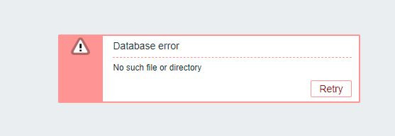

    But the web interface is not working for me now. shows me error:
    Database error
    No such file or directory

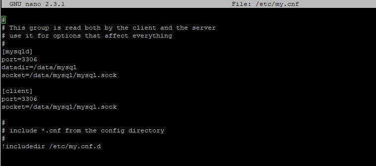

    I went to the php.ini configuration file located at:
    /etc/opt/remi/php72/php.ini and there add the new socket path and it looks like this:
    pdo_mysql.default_socket=/data/mysql/mysql.sock
    mysqli.default_socket =/data/mysql/mysql.sock
    And restart the service httpd But it still doesn't work for me, what else should I modify?

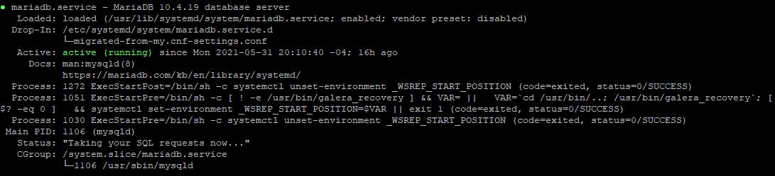

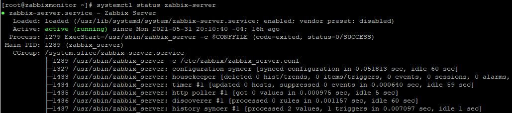

    I leave here the error message that gives me and how is the directory of the DB after having changed it to the new partition.

      Answering your other question the Socket as I see this in the new partition to which I moved the DB. is here:
      Anyway I'll leave an image of it and the file My.cnf where I copy the new path of the DB

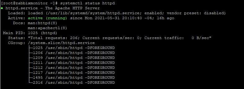

        I forgot to comment that yes, the zabbix server and mysql services are running as well as apache. Anyway I leave here images of the status of these services.

                  And [email protected] Here I leave you the version information of PHP and Apache that I have installed. In case this information can be useful.
                  Thanks.
                  [root@zabbixmonitor ~]# httpd -v
                  Server version: Apache/2.4.6 (CentOS)
                  Server built: Nov 16 2020 16:18:20
                  [root@zabbixmonitor ~]# php --version
                  PHP 7.2.34 (cli) (built: Apr 28 2021 07:30:49) ( NTS )
                  Copyright (c) 1997-2018 The PHP Group
                  Zend Engine v3.2.0, Copyright (c) 1998-2018 Zend Technologies

                    [root@zabbixmonitor ~]# ls -la /data/mysql/mysql.sock
                    srwxrwxrwx 1 mysql mysql 0 Jun 1 13:14 /data/mysql/mysql.sock
                      total 0
                      drwxr-xr-x. 3 root root 19 May 31 12:06 .
                      dr-xr-xr-x. 18 root root 256 May 28 11:59 ..
                      drwxr-xr-x. 5 mysql mysql 265 Jun 1 13:14 mysql
                      total 188492
                      drwxr-xr-x. 5 mysql mysql 265 Jun 1 13:14 .
                      drwxr-xr-x. 3 root root 19 May 31 12:06 ..
                      -rw-rw----. 1 mysql mysql 32768 Jun 3 06:53 aria_log.00000001
                      -rw-rw----. 1 mysql mysql 52 Jun 3 06:53 aria_log_control
                      -rw-rw---- 1 mysql mysql 14039 Jun 1 13:14 ib_buffer_pool
                      -rw-rw----. 1 mysql mysql 79691776 Jun 3 10:16 ibdata1
                      -rw-rw----. 1 mysql mysql 50331648 Jun 3 10:16 ib_logfile0
                      -rw-rw----. 1 mysql mysql 50331648 Jun 2 21:43 ib_logfile1
                      -rw-rw---- 1 mysql mysql 12582912 Jun 1 13:14 ibtmp1
                      -rw-rw----. 1 mysql mysql 0 May 28 11:33 multi-master.info
                      drwx------. 2 mysql mysql 4096 May 28 11:33 mysql
                      srwxrwxrwx 1 mysql mysql 0 Jun 1 13:14 mysql.sock
                      drwx------. 2 mysql mysql 20 May 28 11:33 performance_schema
                      drwx------. 2 mysql mysql 12288 May 28 11:44 zabbix
                      -rw-rw---- 1 mysql mysql 5 Jun 1 13:14 zabbixmonitor.pid

                        The perms look fine so it's not that. Have you put in place or updated the zabbix Web config file to reflect the new socket? I.e. in the /etc/zabbix/web.... this is the next thing I would look at... what's the contents of the config file - exclude any confidential information please....
                        • jolalla
                          • May 2021
                          • 45
                          Hello [email protected] thank you one more time
                          I went to the path etc/zabbix/web and there I opened the file zabbix.conf.php but I did not see information related to the socket.
                          The content of this is as follows:

                            [email protected] The places where I found socket information and where I added the new path where the socket is located was here:
                            etc/opt /remi/php72/php.ini and here add the information like this:
                            ; Default socket name for local MySQL connects. If empty, uses the built-in
                            ; MySQL defaults.
                            ; http://php.net/pdo_mysql.default-socket
                            ; MySQL defaults.
                            ; http://php.net/mysqli.default-socket
                            mysqli.default_socket=/data/mysql/mysql.sock
                            And the other place where I found information about the socket and where I also added the new path was here:
                            etc/zabbix/zabbix_server.conf and here add the information like this:
                            ### Option: DBSocket
                            # Path to MySQL socket.
                            # Mandatory: no
                            # Default:
                            DBSocket=/data/mysql/mysql.sock
                            I added this information to you in case it can be useful and to know if what I add is right or wrong. In the same way, with that added, it doesn't work for me: (

                              Hi Jolalla,
                              The other thing that springs to mind is if there are multiple versions of PHP installed perhaps the web server is using php from another path as it may not have been set in the environment or something?
                              Can you run the command 'rpm -qa | grep php' and list the packages...
                              Can you please run and show the results:
                              * /bin/su -s /bin/bash -c 'which php' apache
                              /bin/su -s /bin/bash -c 'which php' nginx
                              Cheers
                              James
