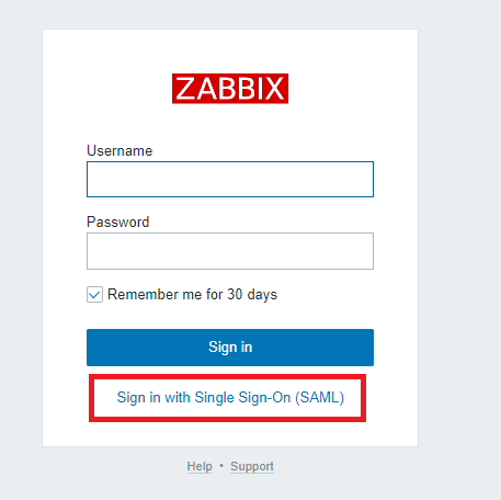

    I set up the zabbix with docker image like down below
    everything is working well except SAML.
    Here's my configuration
    and idp.crt attached into the zabbix-web container with file (tried with volumes : docker-compose and configMap : k8s and file creation : vi editor)
    I was expecting that clicking the SAML button would redirect to the SSO URL. but It's not.

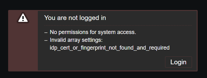

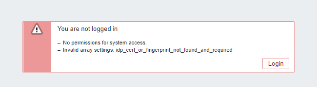

    I got two errors like down below

    • No permissions for system access.
      • I don't know what this mean.
      • Is that mean that I can not excute the index_sso.php which is made with root in the container?
      • but other files are all the root
    • Invalid array settings: idp_cert_or_fingerprint_not_found_and_required
    How can I solve above issue?

      I had this problem and managed to solve it.
      In my case, the IDP certificates were stored in the wrong folder.
      Moving the certificates from folder "/usr/share/zabbix/conf/certs/" to "/etc/zabbix/web/certs/" did the trick.
