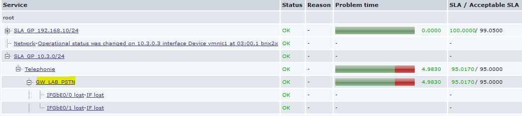

          I also attached a screenshot of the SLA "GW_LAB_PSTN" state which values I was trying to get with that code.

            Sorry, I don't see attachment with screenshot
            • ArnaudG
              • Apr 2015
              • 9
              Sorry, it did not upload well the first time and I did not check either...
