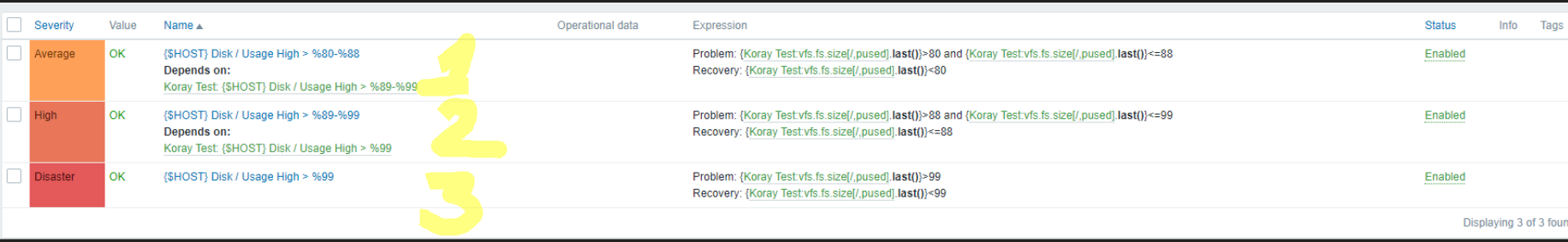

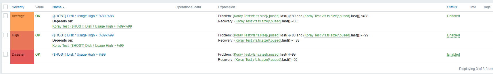

      Hello Thanks for your return.
      I have fixed this like.
      • korayak88
        • Oct 2020
        • 19
        Actually i have tested
        for example the disk usage equal 100 the trigger number 3 is running
        after i removed %1 something the trigger 3 recoveryed is succes and closed the trigger 3 and after the disk usage = 99, the trigger 2 is started running.
          Your recovery expressions are useless there.. They would only make difference, if you would set recovery to different (lower) values from the trigger activation level.
          Like that Disaster trigger.. it activates if value is over 99. So recovery being at same level is useless. Trigger will deactivate anyway, if value drops below 99..Setting recovery to 95 for example, will delay deactivation, until that value drops below 95...
            Yes, that is correct, but all that will work without those recovery expressions also.. Recovery expression is "additional condition to satisfy for resolving a trigger"... So both problem and recovery expressions have to be satisfied. Your trigger condition turns false when values drop below 99, so you don't have to add secondary (recovery) condition, that this has to fall below 99..
