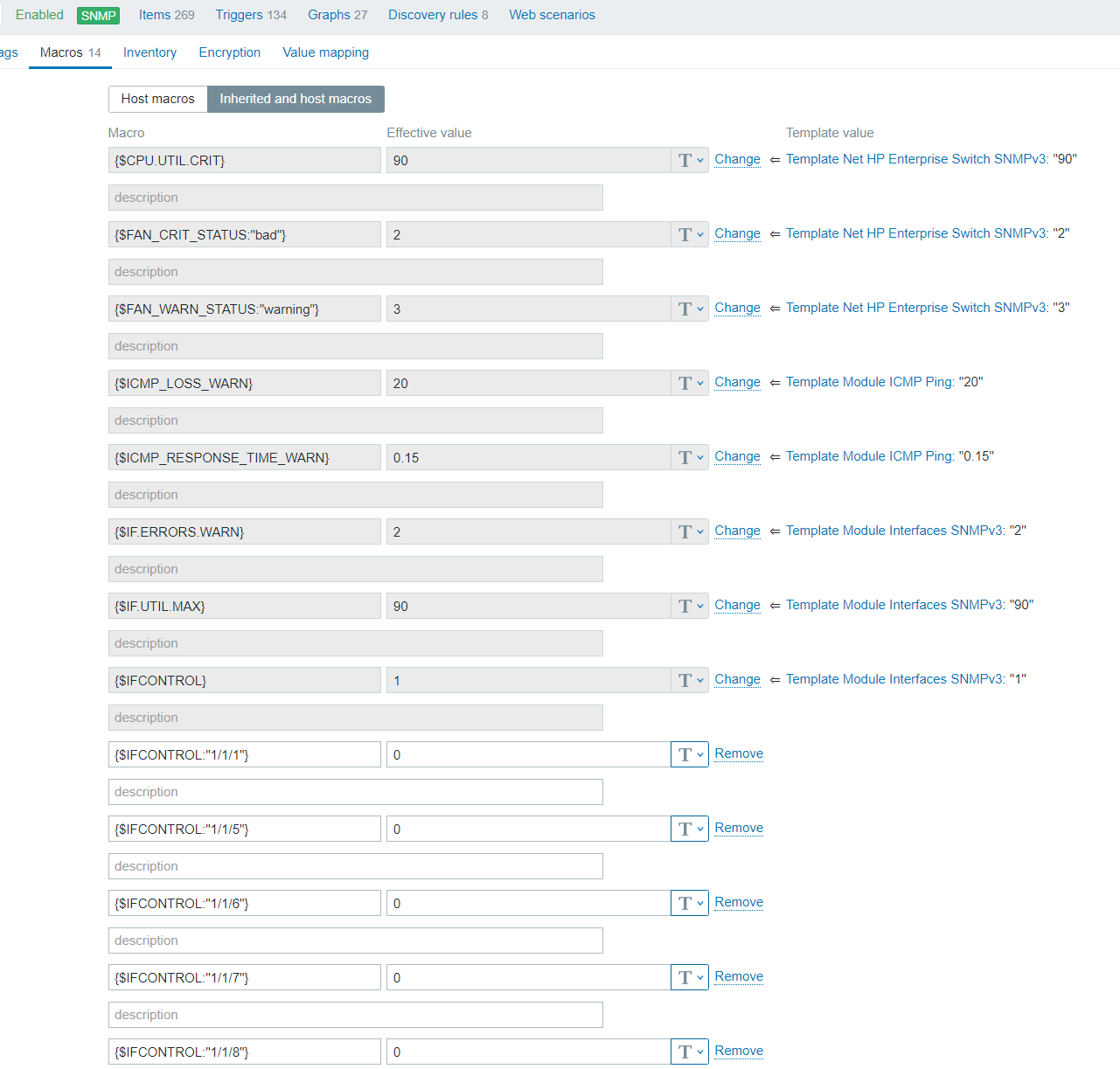

            Yes, the OVERRIDE feature that @Harmardaban pointed to allows for this opportunity. If you edit the specific switch you have in mind, look at the MACROS tab to see which macro's are inherited from the template.
            You can then create manual macros on the switch with detailed settings pr. port - which overrides the general setting pr. port.
            The template already has built-in provisions for this need. It holds a Macro called $IFCONTROL, and if that has a value of 1, it will alert on link down. If it has a value of zero if will disregard alerts on link-down events.
            Here's a snippet from my macro settings where you can see the inherited global $IFCONTROL with a setting of 1 (Greyed out so cannot be changed).
            I have then made some manual overrides for specific ports to disable Alerting.
            Hope it makes sense.
