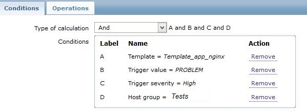

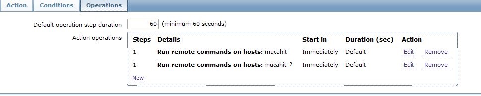

    Hi
    A question about remote command. Is it possible create a action for a host group and that is send a script for just one host which one has a problem ?
    I did create a action for host group but when a service down in the host, action send the scripts to all host (it is the disaster). But i ve got so many host group and I dont want create actions for all host one by one.
    mucahit and mucahit2 in same host group and has some template

    There is a reference here:
    That action commands support macros. However it also looks like action scripts in general are limited to agents that are directly monitored by zabbix server (not via a proxy).
    If you are setting the action to run on the zabbix agent, then you could use a macro like {HOST.IP} as a parameter to your script, and then have the individual hosts check that and exit the script if running the script is not desired.

      I've been searching macros example in web with your advice. I try to use {HOST.IP} also {HOST.HOST} in script, like that {HOST.IP} sudo /etc/init.d... but script working perfectly although still same problem, sended 2 command to my 2 test host at same time..
      I' m not sure do I enter the macro in the host configuration ?

        Sorry if I was not clear. I meant to imply that you should pass the host name or IP to your script. So something like:
        /usr/local/bin/myscript {HOST.IP} parameter2 parameter3 ...
        Then within your script, you decide (based on the passed in host/ip address) if the script should run.
        I don't think there is a way to set an action group so that only a particular host is contacted to run a script. So by my example, zabbix connects to all hosts as usual, but then the host script decides if it should do something or not.
        Or at least that is the theory ... I haven't tried this myself ... I hope it helps.
