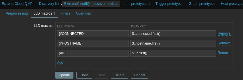

                    Hello again,
                    So after some more testing we actually found something that works.
                    We added .first() in the LLD configuration like this:
Name:	Screenshot from 2022-06-10 13-05-53.png
                    This works for us as far as I can see. Not exactly sure why...
                    /Jo Christian
                    • Noobz
                      • Jun 2020
                      • 105
                      Yep, the .first() solution works, but it is not apparent exactly why it works, it certainly isn't intuitive.

                          • eertul
                            • May 2018
                            • 10
                            #15
                            Originally posted by jochristian
                            Hello again,
                            /Jo Christian
                            Thanks! "first()" function nailed it!
