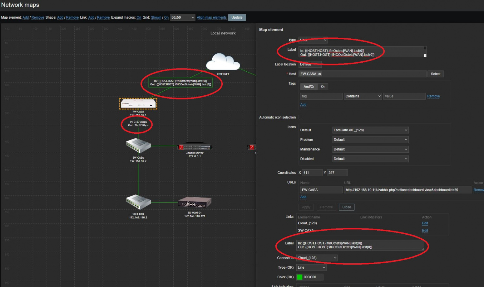

    Hi team:
    I am having a problem that the macro does not work for me on the label of a "Link". Te same macro on the label of the "map element (host)" it works perfectly (please see attached image). I have Zabbix 5.4, I don't know if someone experienced the same problem.
Name:	Map Macro Link Label Problem_.jpg
    Thanks in advance.
    Martin Pedros
  • Hamardaban
    • May 2019
    • 2714
    Think about it - which host will the {HOST.HOST} macro on the connection connecting two hosts map element relate to?
    • martinpedros
      martinpedros commented
      Dear Hamardaban,
      First, thank you very much for your quick response, it has really been very helpful for me. I think I made a beginner's mistake which was not to read the documentation before making the query and I apologize for that. You have reason to use the macro, in the documentation it clearly said that you should use the following form: "{host: key.func (param)}", use the following:
      In: {FW-CASA:ifInOctets[WAN].last(0)}
      Out: {FW-CASA:ifHCOutOctets[WAN].last(0)}
      ... and it is already working correctly. I'm really starting with Zabbix and contributions like this are very helpful to me.
      Thanks!
