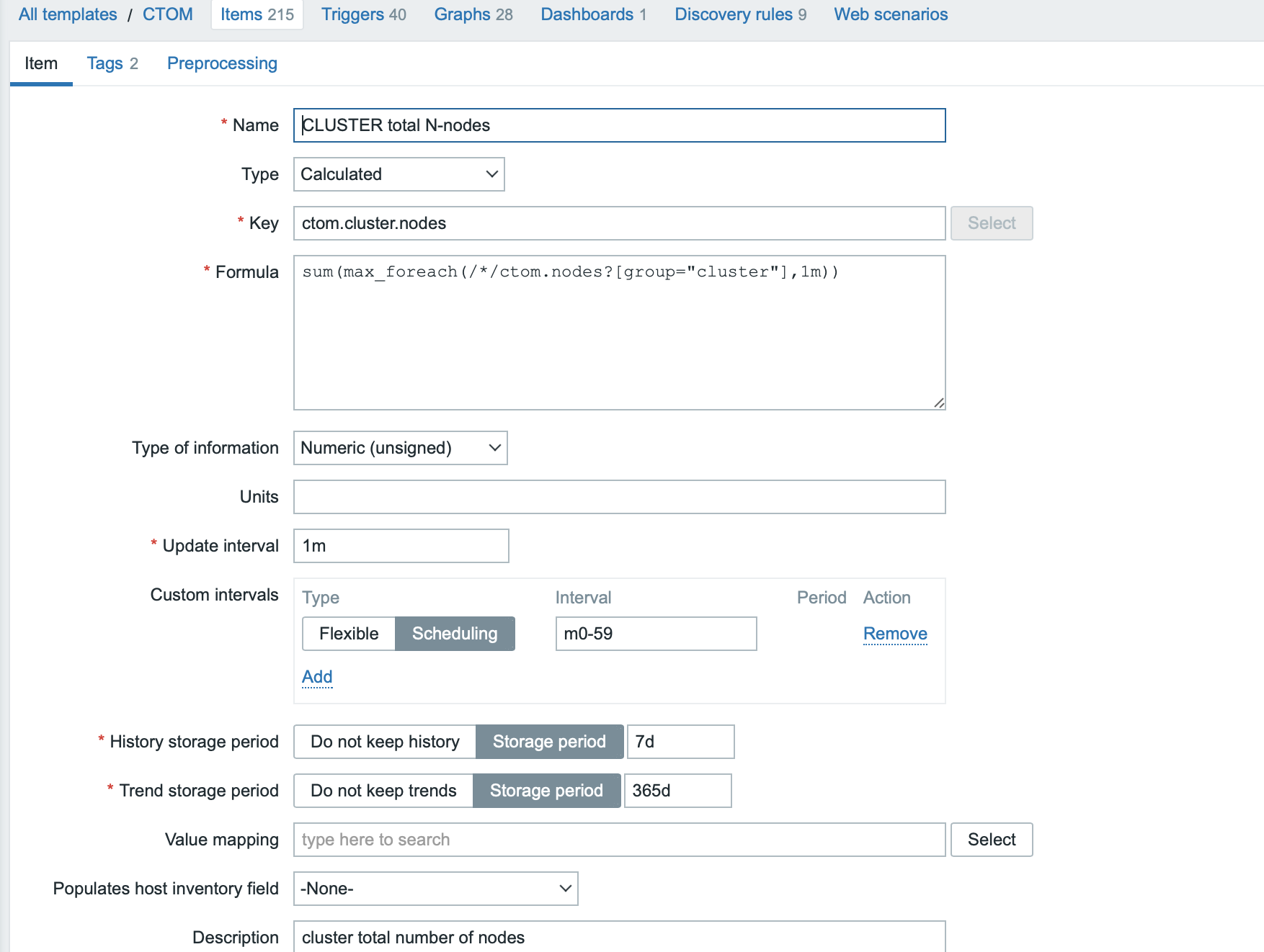

    Thanks for your reply. I use Zabbix 5.4.1. So what is the syntax to calculate the sum of an attribute of the hosts in a group, on the last minute ( only for the attribute is available in the last minute, zero else ) ?
    exemple
    host Attribute value last value A min
    A. 3
    B unavailable
    C. 2
    total = 5

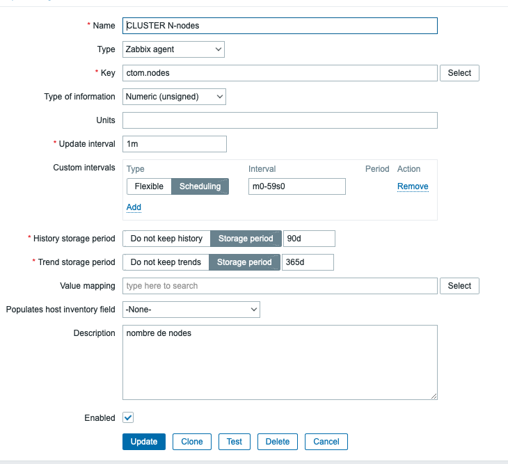

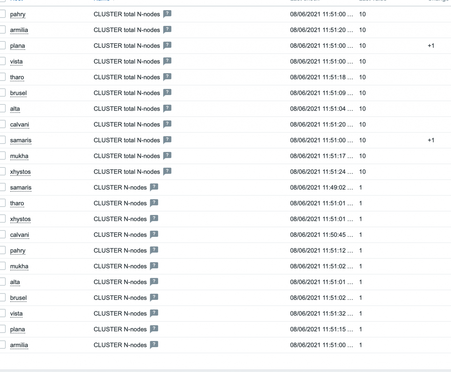

      Thanks for your reply, I made it but I did not get the good results. I wait for 11 as a good result but I get 10. Because at 11:51, the sum is made for the fields that have timestamp between 11:50 and 11h51 but for one machine in group the value was get at 11:49 . (look at the picture)
      How can I get the value at the same timestamp on every nodes ? I put scheduling = m0-59 in item parameter but it does not work ?
      Sorry for my bad English.

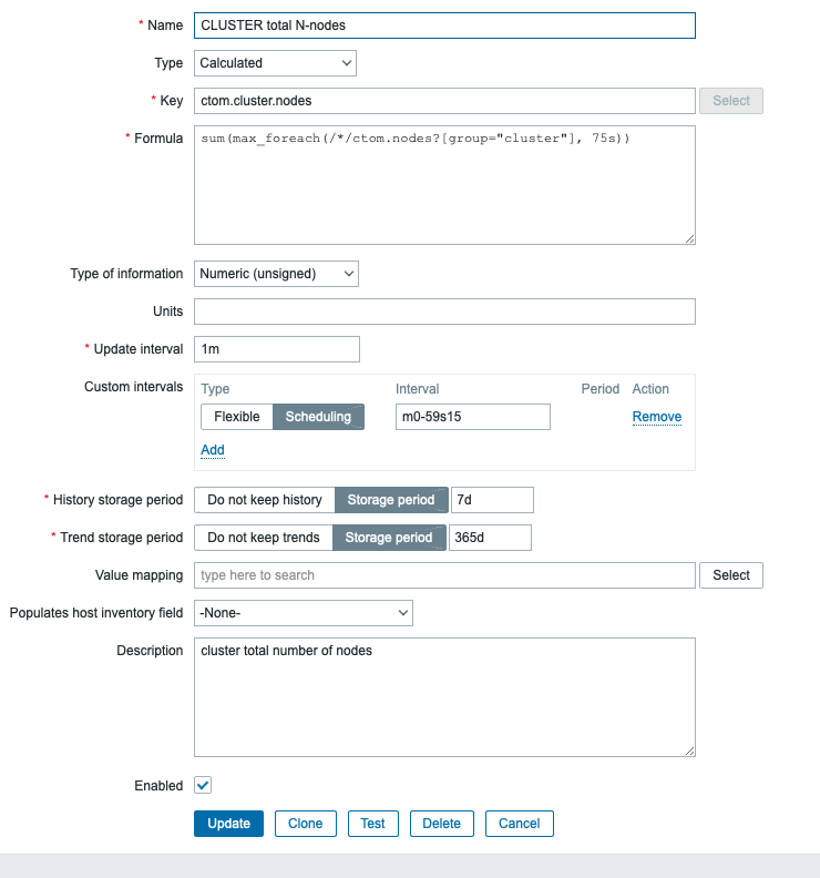

        Can you test with setting scheduling to = m0-59s0 for "normal" items and scheduling = m0-59s15 for caclulated items?
        I add a 15s difference to items scheduling, we need to be sure that the data for the normal item are "fresh" (collected just before the computation in clalculated items). If we have the same second then we cant be sure of the order ("collect and next calculate" or "calculate and next collect").
        Also you can replace "1m" in calculated items with "75s" - so calculation will take also "delayed" data. You have in calculation "max", witch means if our "window" (time "75s") get two values then it will choose max from this both. You can swich this "max" to "min" to have different behavior.

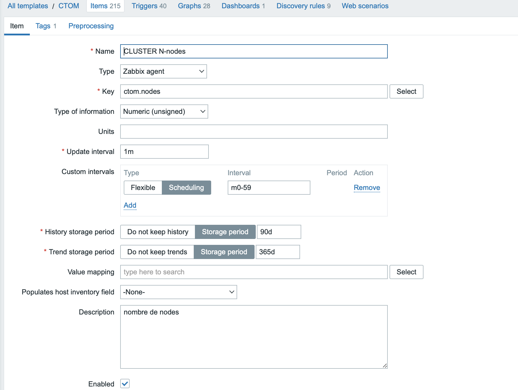

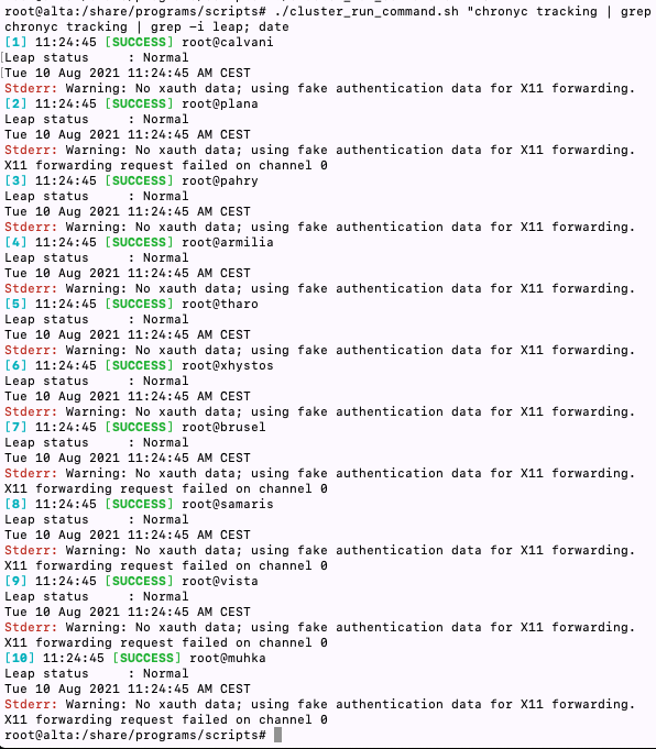

          Ok thx I have done it now but I have same problem (attached files : 2 nodes are not on the same timestamp so total = 9 ) I dont understand because the node date times are well synchronized with chrony
          i have restarted zabbix agents and zabbix- server services but the problems stays

            Now I see what can be wrong... set interval to 0 because as in doc (https://www.zabbix.com/documentation...om_intervals):
            Scheduling intervals are used to check items at specific times. While flexible intervals are designed to redefine the default item update interval, the scheduling intervals are used to specify an independent checking schedule, which is executed in parallel.
            So "normal" interval doing additional checks (in parallel) besides this scheduled checks.

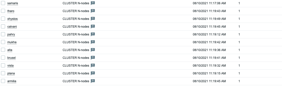

              Thanks I do it now but I have two machines still not synchronized.... I restart Zabbix-agent and server but same ...
