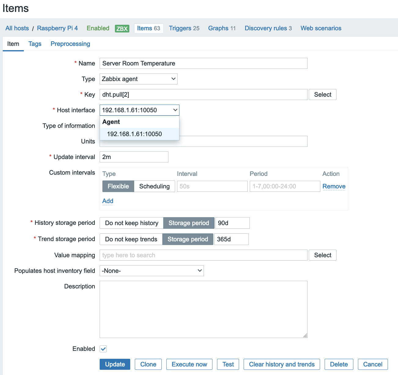

            Most of what is said above makes sense, but the GUI interface as far as item cloning stumped me. I was not woking with templates, but with individual items on a host. I chose an item I had made earlier, thinking I could "clone" it to another host. But once in the clone detail page, I did not know how to assign it to a different host. The "Host Interface" drop down did not offer any other option than the host/IP it was cloned from, making it unclear to me how to clone/copy the item to another host. I could change the name or the key, but I wanted to change the host (see attached screen shot). Still haven't figured that out...
            I think my confusion is related to the interpretation of "clone" vs "copy".

              Well, when you "clone", you're duplicating item for that same host. When you "copy", you're literally making a copy of that item for another host/group/template.
              Cloning:
              - create same item for the same host with slightly different key parameters and name.
              Copying:
              - you've created some item and want to copy it to another host, hosts group or some template you've created earlier.
              Why copy to the template instead of hosts group? Because if you copy to the hosts group, these items copies will be independent and you can change them individually per host. But if you put this copy to some template and then assign this template to some hosts, later you might want to change something in that item for all hosts. For that you just need to make changes in the template and they'll be changed on all hosts with that template, so you won't need to change same item for like 20 hosts 20 times.
