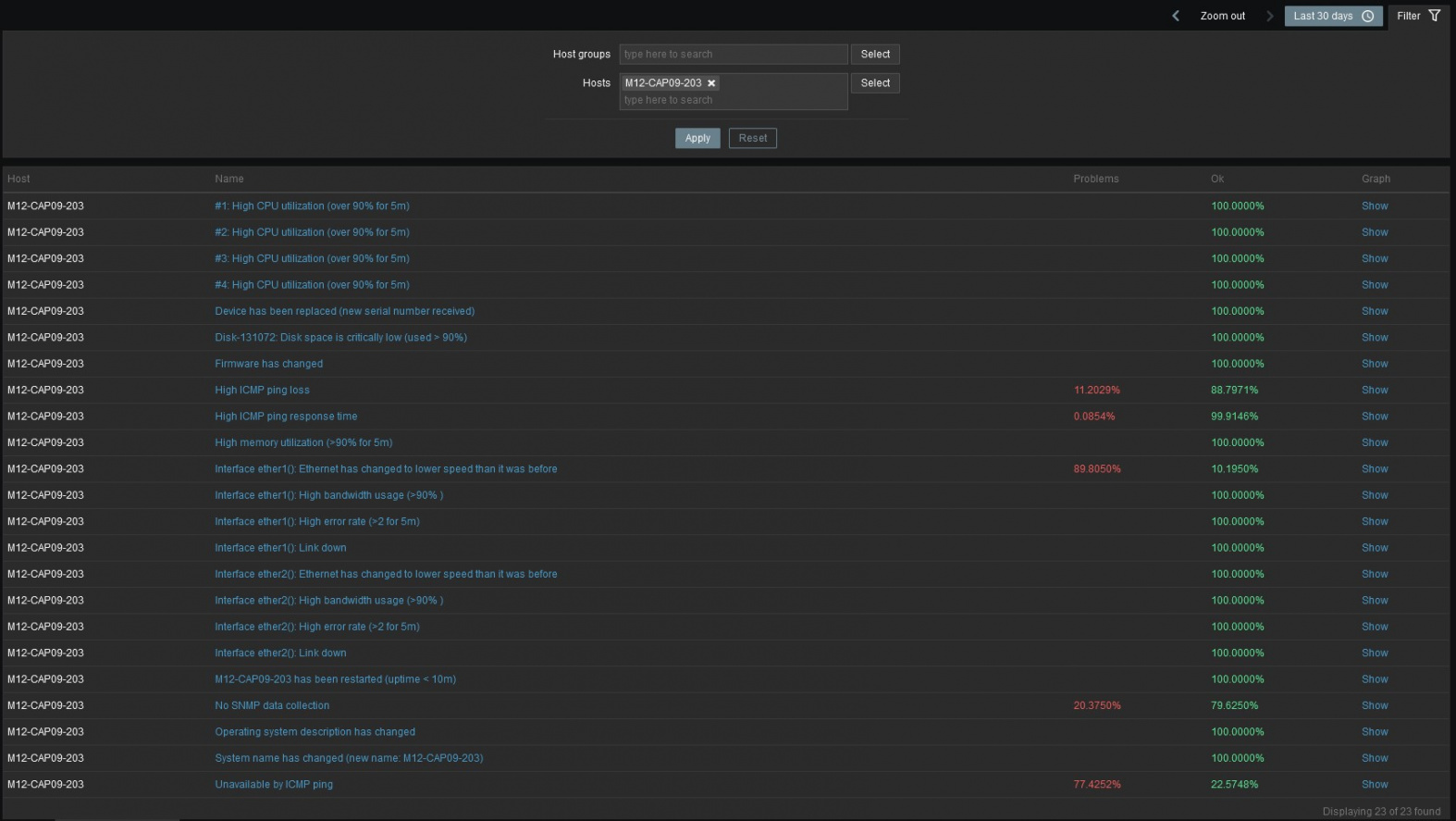

        Well, I think in case of getting availability you can use availability reports. You can get them per host, host group or per trigger template. They're not really comfortable to operate with and I didn't found out how to get result for only one trigger, not all of them for one host, but it can get the job done.
        The benefit is that you can just choose any time interval you want with filter (like in graphs or latest data: "now-2w - now" - last 2 weeks) and it will give you result in percentage. It may be not extremely accurate, because it's basically the time some trigger (for example host ICMP ping unavailability) being active divided by your chosen time range. So if your trigger activates only after 5 minutes after host stopped being available, this report will assume that during these 5 minutes host was online and only after that became offline. Just depends which item and trigger with which settings you'll use. I think this feature would be easier to use.

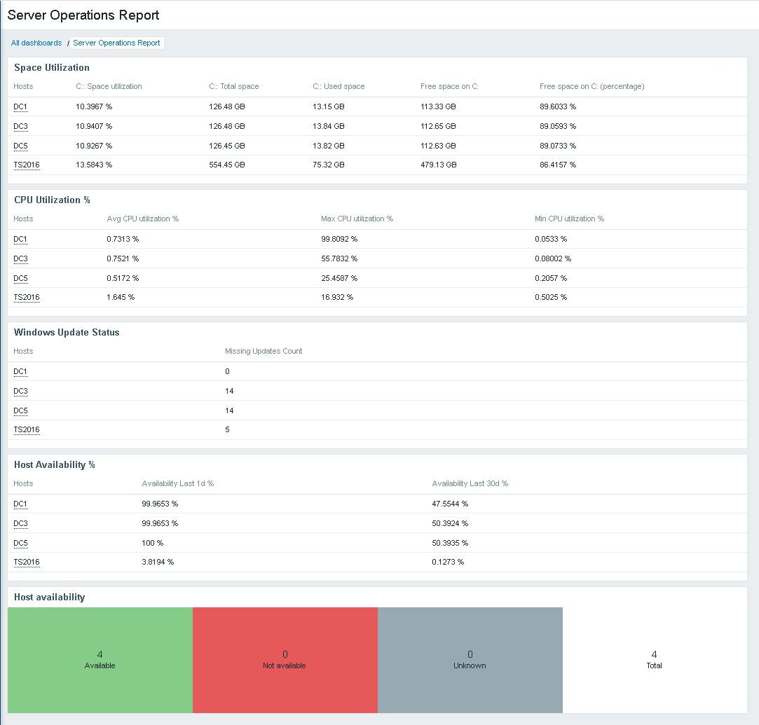

        • Rihis
          • Aug 2021
          • 14
          Availability reports currently are clumsy and really uncomfortable. You can choose only one trigger and the host group if you choose mode By trigger template and that gives you pretty much acceptable look. But the problem is that you can not integrate it in any Dashboard. My customers are looking for informative, customizable, fully automated and good looking Reports which contains all the necessary data about their servers. Therefore I am trying to create example Dashboard. Its just the beginning but looks good so far.

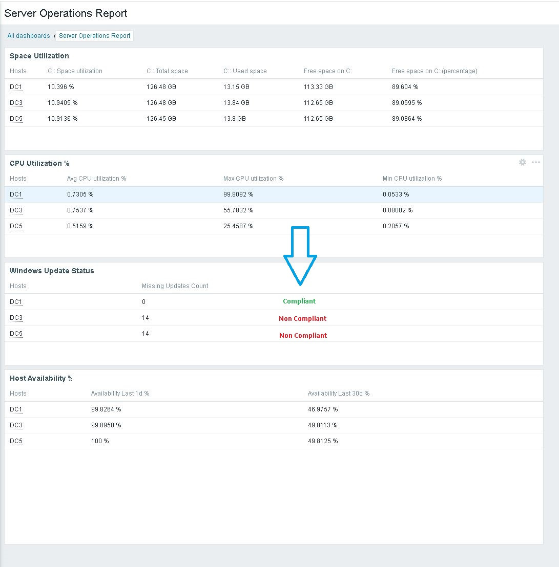

              • Rihis
                • Aug 2021
                • 14
                BTW, probably you have idea how to create Item or Trigger (or something else) which generates Status "Compliant" if Value is 0 and "Non Compliant" if value is >0

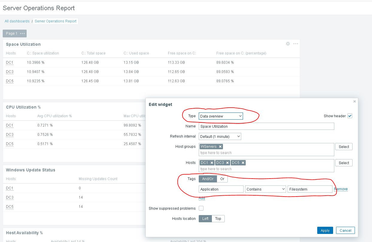

                  • Rihis
                    • Aug 2021
                    • 14
                    I am using Zabbix 5.4.2 and Widget type - Data Overwiev. In the new versions of Zabbix you can add Tags to Item and I use Item Tags to filter out necessary info. In the picture below I used Items and Tags which comes Out-of-box in Zabbix but in all others I created the Calculated Items and Tagged them with my Tags.

                    • johndoe2374
                      • Aug 2021
                      • 80
                      Oh, thanks a lot, never used new tags system before. Now I know, where it can be used )

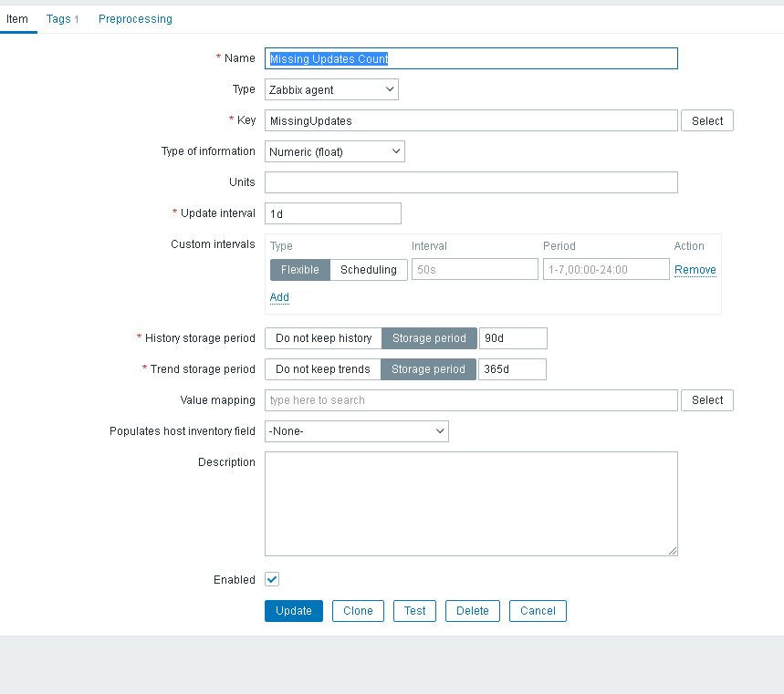

                      • Rihis
                        • Aug 2021
                        • 14
                        I created a new custom Item which uses UserParameter to run simple script on the host. This script returns the needed value. I know how to create the trigger for this Item but do not know how to display it in the Dashboard.

                        • johndoe2374
                          • Aug 2021
                          • 80
                          Well, it's a mystery for me where it comes from then. I guess you'll have to use "Trigger overview" widget separately or something about "problems". Don't think panels have functionality to display mixed types of data in the same widget...

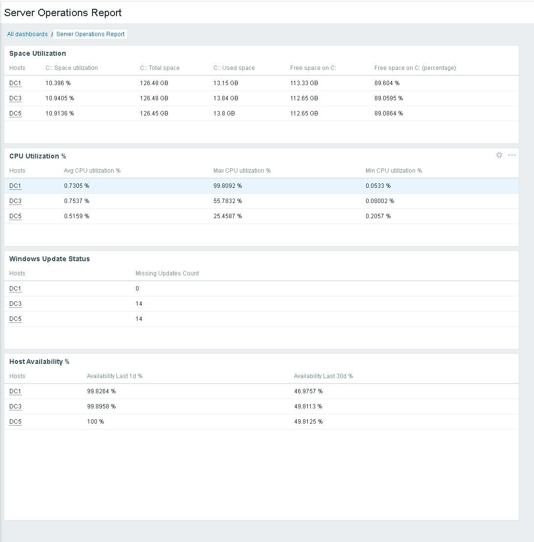

                        • Rihis
                          • Aug 2021
                          • 14
                          This is fully automated Zabbix dashboard. You just add host to Zabbix and it populates Dashboard fields without any user intervention. I am trying to make it more informative and good looking - customers like it

                          • Kos
                            • Aug 2015
                            • 3468
                            #15
                            Hi!
                            Did you try to use a value mapping for this item?
                            Something like the following:
                            0 => Compliant
                            Default: => Non Compliant
