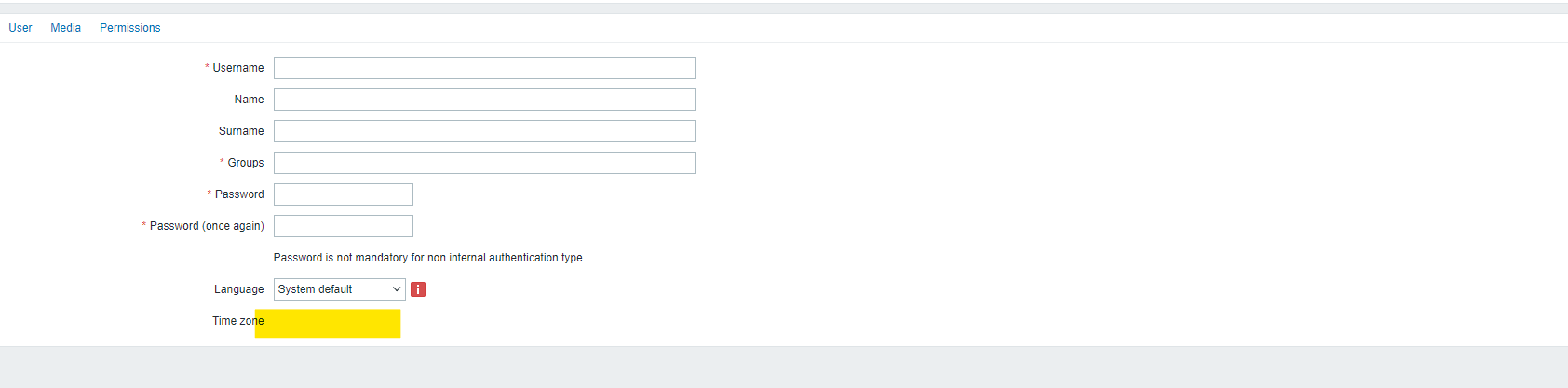

    Today i try to create users. (it work before)
    But , i have a timezone issues.

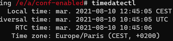

    timedatectl is set for Paris.

    ok i found it
    I log into the server itself and it work.
    With a Vpn/SSL access it seems not possible.
    Any idea how to fix timezone for external administration ?
