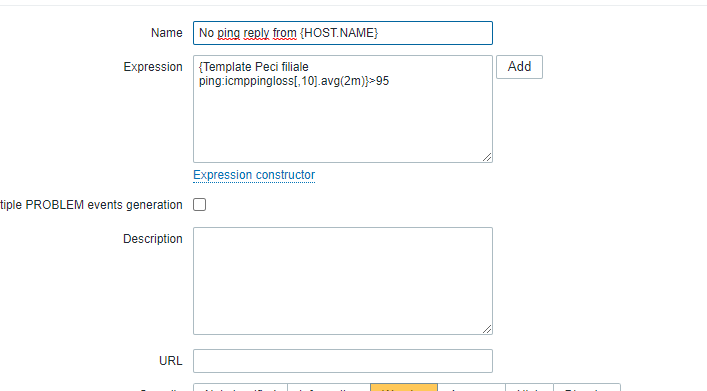

    Hi everybody. Been seeking for help for some time and read thru the topics listed in the forum, but can't get it working. Any help would be appreciated.
    I am monitoring about 250+ devices without a Zabbix agent, just using simple checks icmpping and others. My devices should be online 24/7 but are not critical devices. Thus I want to know when one of these devices goes offline and get an alarm. I would like 2 scenarios:
    1. the device being offline for at least an hour (or it could be even more) -> I think icmpping.max(60m) could be used here?
    2. the device loosing connectivity (in case of a cabling problem, broken cable or something) -> might be icmppingloss?
    So I would like to be notified when a device is losing ping replies constantly and another notification in case of full conectivity loss. I tried with ping, pingloss, pingsec...but I can't get it working right - I am getting notifications of inaccessible hosts every few minutes, being all unclear at this much of emails I receive. If it would help, I can post my items and triggers screenshots. But maybe it would be easier to just delete all of them and start from scratch with your suggestions and help.
    Thank you very much in advance!
    BR, Dean

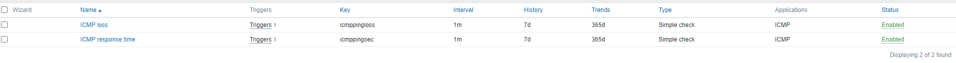

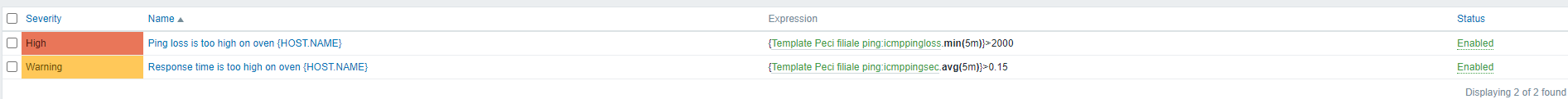

        I tried now the default ICMP ping template with default values. I get lot of triggers (email notifications) regarding response time is too high and neither one notification regarding offline devices, thus I know there are a few that are inacessible on the network. I can't figure out the right expressions I think. Attached are my items and my triggers.

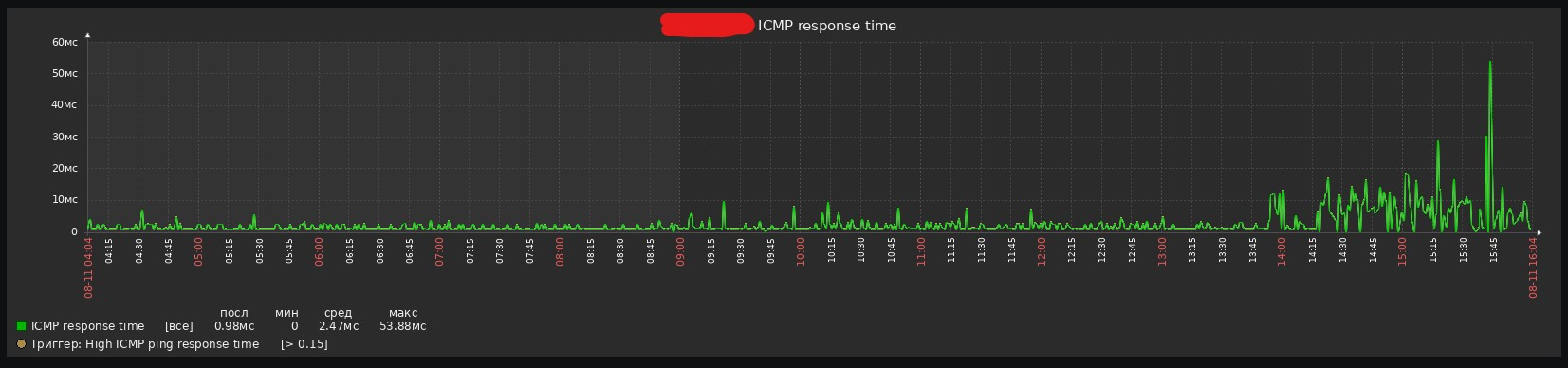

          If your response time considered being too high it means that average response time for last 5 minutes is higher than 0.15 seconds (150 ms). Again, check actual response time values for different hosts and find out whether it's normal or not. Then adjust macros or time range (instead of 5 minutes) accordingly. You can check graphs in "some host's latest data" > "filter by name - icmp" > "graph link":
          As you can see, for this 12-hour period normal response time is below 10 millliseconds. But starting at 13:50 there's anomally, so I can adjust macro to 0.1.
          • deanw
            • Aug 2021
            Thank you again, I'm gonna leave it now for a few hours, to get at least some data onto my graphs and then start struggling around. So, just correct me if I'm wrong - if you would now adjust your macro to 0.1 you still wouldn't get any notification or triggers, because 0.1 means 100ms, your peak response times were on the graph above about 55ms. And if you changed your macro to 0.01 you would get notified at about 13:50 when the times peaked up above 10ms. Is that correct?
            • johndoe2374
              johndoe2374 commented
              Yep, my bad, I've meant 0.01. You've got the idea.

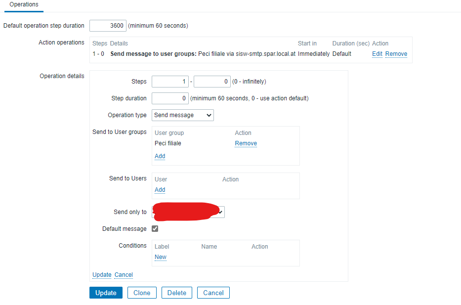

              One more question raised up. I would like to get notified daily, everyday at 8:00 about offline hosts, but still be able to lookup in Zabbix frontend the history (graphs). So it should ping the hosts every hour but only notify me on offline hosts once a day in the morning. How do I have to configure Zabbix? Where do I have to define that and/or put those 86400 seconds - is that in the update interval of the item or in the default step duration in the Action operation, maybe in the step itself? Or do I maybe have to define the Item interval flexible and enter h8 in the scheduling interval field? I'm confused with all that time options everywhere...

                Read the docs, there's plenty of good examples (table about scheduling intervals):
                Don't forget to adjust triggers if they're used with an item accordingly.
