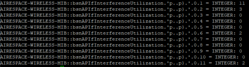

    I'm trying to fetch the channel utilization by interference on a Cisco AP via SNMP V2C.
    The problem is that this value depends on the current channel of the AP and there's no OID to return this value based on this condition. Instead, the OID 1.3.6.1.4.1.14179.2.2.14.1.22 of the AIRESPACE-WIRELESS MIB returns a list of the values for all channels on the interface of interest (2.4 or 5 GHz).
    The image below shows what the raw data looks like.
    So if the current channel is 1, then I should get a value of 11%. On the next polling time, if the current channel is 6 then I should get 2% for my item.
