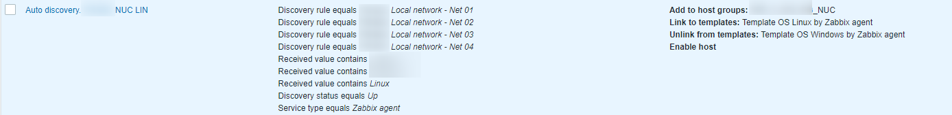

    In "Action - Discovery Rule" , I am setting 2 different "Auto Discovery Rules"
    [Works Perfect] Rule 1) Using Received Value to be certain something --> This works great, so systems with Zabbix agent gets filtered and added to correct pockets (host groups)
    [Dont Work] Rule 2) Is as below, i tried both "And" or "Or" both doesn't seem to work to filter -- > this results into my 2nd host groups containing both Zabbix Agent hosts and SSH hosts
    Any Idea on how can i solve this situation?
