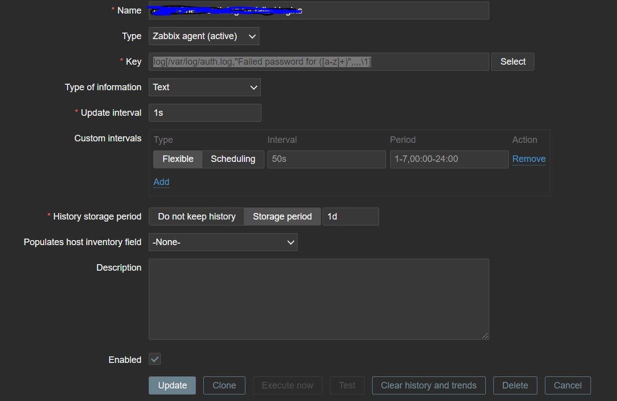

    In this scenario we want to get an alert, when the item gets a value in the last two ours. Therefore we created an "log" item with the following
    item key.
    log[/var/log/auth.log,"Failed password for ([a-z]+)",,,,\1]
    Click image for larger version  Name:	zabbix-item.JPG Views:	15 Size:	96.8 KB ID:	430312
    So we just get the username of the Logentry and only if there is a failed login.

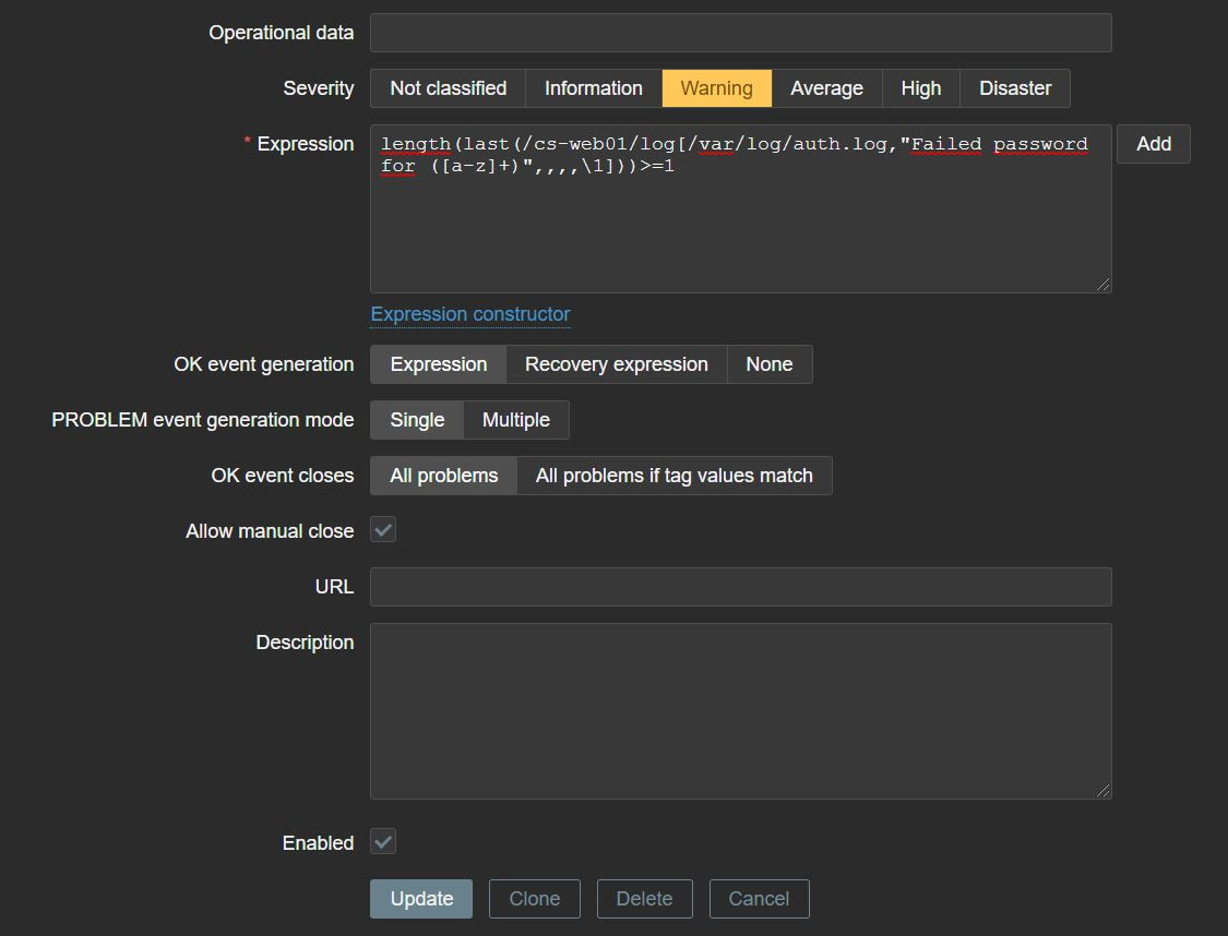

    The trigger should work, but there is the issue with the expression result converting.
    length(last(/cs-web01/log[/var/log/auth.log,"Failed password for ([a-z]+)",,,,\1]))>=1
    Click image for larger version  Name:	zabbix-trigger.JPG Views:	15 Size:	99.9 KB ID:	430311
    Anyone an idea what is causing this issue? We are a littlebit confused

      The delete and recreate solution did the trick.
      Problem solved!
      THANKS to all of u!

          Ok so what seems to have happened is, when I was trying to figure out expressions, I saved it with something that gave that error. But then all the updates I've done to it since don't clear/remove that error. Because now that I have deleted the trigger and re-created it, it works perfectly.
          It really sounds quite ridiculous, but just try it... delete trigger and recreate it..:P
