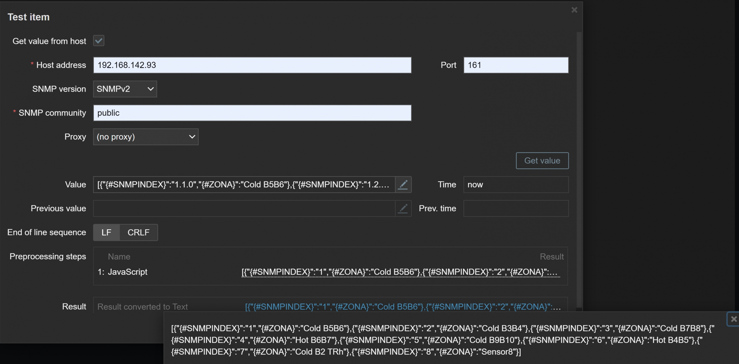

              I'm trying to set low-level discovery using SNMP to put item value (SNMP OID value) into another item name.
              Now I'm stuck with that "OID not changing." error.
              I created Template with discovery rule like this:
              Then I created Item Prototype, but my Discovery rule doesn't work with host I created with that Template.
              It says "OID not changing.".
              snmpwalk output is this:
              iso.3.6.1.4.1.38783.1.2.2.1.[B]1[/B].1.0 = STRING: "Cold B5B6"
              iso.3.6.1.4.1.38783.1.2.2.1.[B]2[/B].1.0 = STRING: "Cold B3B4"
              iso.3.6.1.4.1.38783.1.2.2.1.[B]3[/B].1.0 = STRING: "Cold B7B8"
              iso.3.6.1.4.1.38783.1.2.2.1.[B]4[/B].1.0 = STRING: "Hot B6B7"
              iso.3.6.1.4.1.38783.1.2.2.1.[B]5[/B].1.0 = STRING: "Cold B9B10"
              iso.3.6.1.4.1.38783.1.2.2.1.[B]6[/B].1.0 = STRING: "Hot B4B5"
              iso.3.6.1.4.1.38783.1.2.2.1.[B]7[/B].1.0 = STRING: "Cold B2 TRh"
              (without unneeded OIDs and values for what I used JS and regex we talk about).
              OID part that is changing in OID is bolded, and that is in the middle of OID, so, I used that JavaScript to make SNMPINDEX walk from 1 to 8, but this looks completely wrong, because of that "OID not changing." error.
              When I test that discovery rule I get this:
              and this result looks good, but that discovery rule doesn't works with host.
