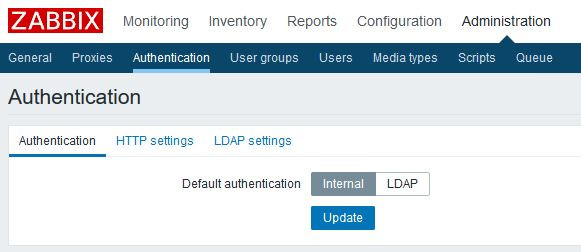

    In the Logon of Zabbix 4 I can select a default-logon like on screenshot:
    I want to use both bethodes, some user from internal (if the dc maybe brokes) and as defaukt Ldap. If I change this to LDAP - can I use DB anymore with Zabbix 4?

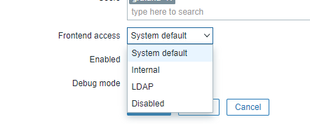

      Hey.
      Your user groups determine if it is to use LDAP or internal for logging in.. You will see the below dropdown when you are in one of the groups which will determine how members of that group authenticate or not if its set to disabled.
      Click image for larger version  Name:	zabbix-auth.PNG Views:	0 Size:	11.4 KB ID:	430374
      What i do is create an internal admin group for those emergency accounts like the NOC teams etc..

        very cool. I checked only or Group Zabbix Administrators - there is no possibility for set this information.But for new groups its fine :-)

          Hello.
          Zabbix Administrators group is using default system-wide access method, looks like you can't change it for that group.
          I do it the next way:
          1. Use internal method for default Zabbix Administrator account and maybe some other admins, as they should have access at any time without depending on AD.
          2. Create another group "LDAP Users" and set LDAP method for them.
          3. Create domain users using their logins and put them into LDAP Users group straightaway, so it would allow you create user without specifying password. Now they will be able to log in using their domain passwords.
          I don't think you will be able to allow the same user use internal authentication and LDAP at the same time. Even if it would be possible, there's no point in that, as you'll have to specify some password for internal authentication method anyway.
