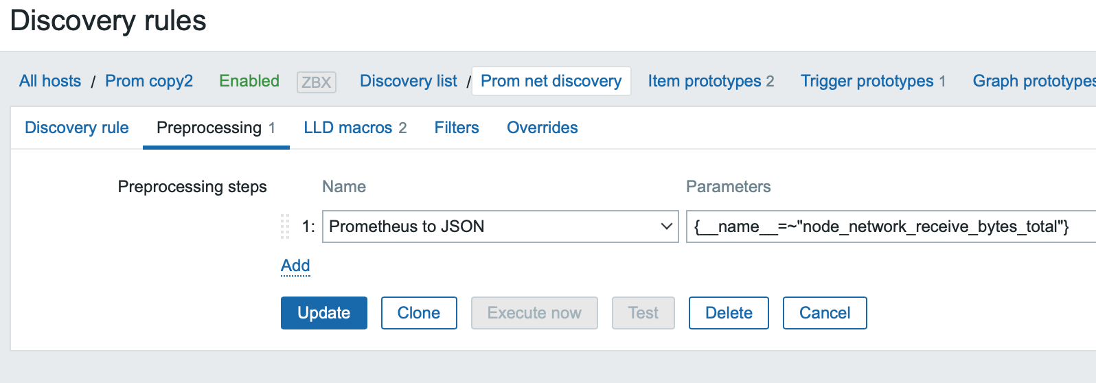

    1. Create dependent discovery rule with Prometheus preprocessing:

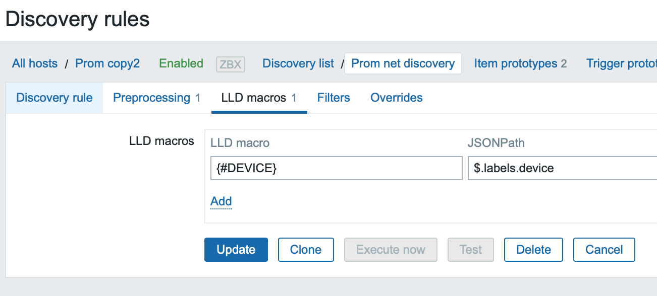

    In this case we need to map just one LLD macro:

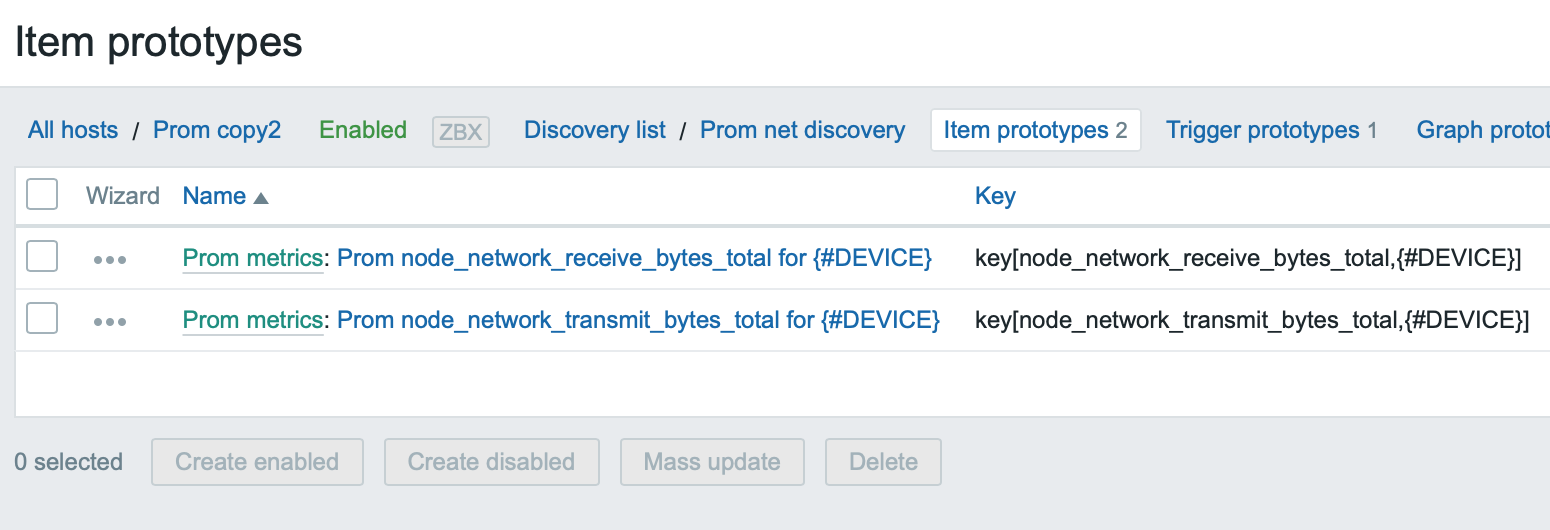

    2. Add two item prototypes:

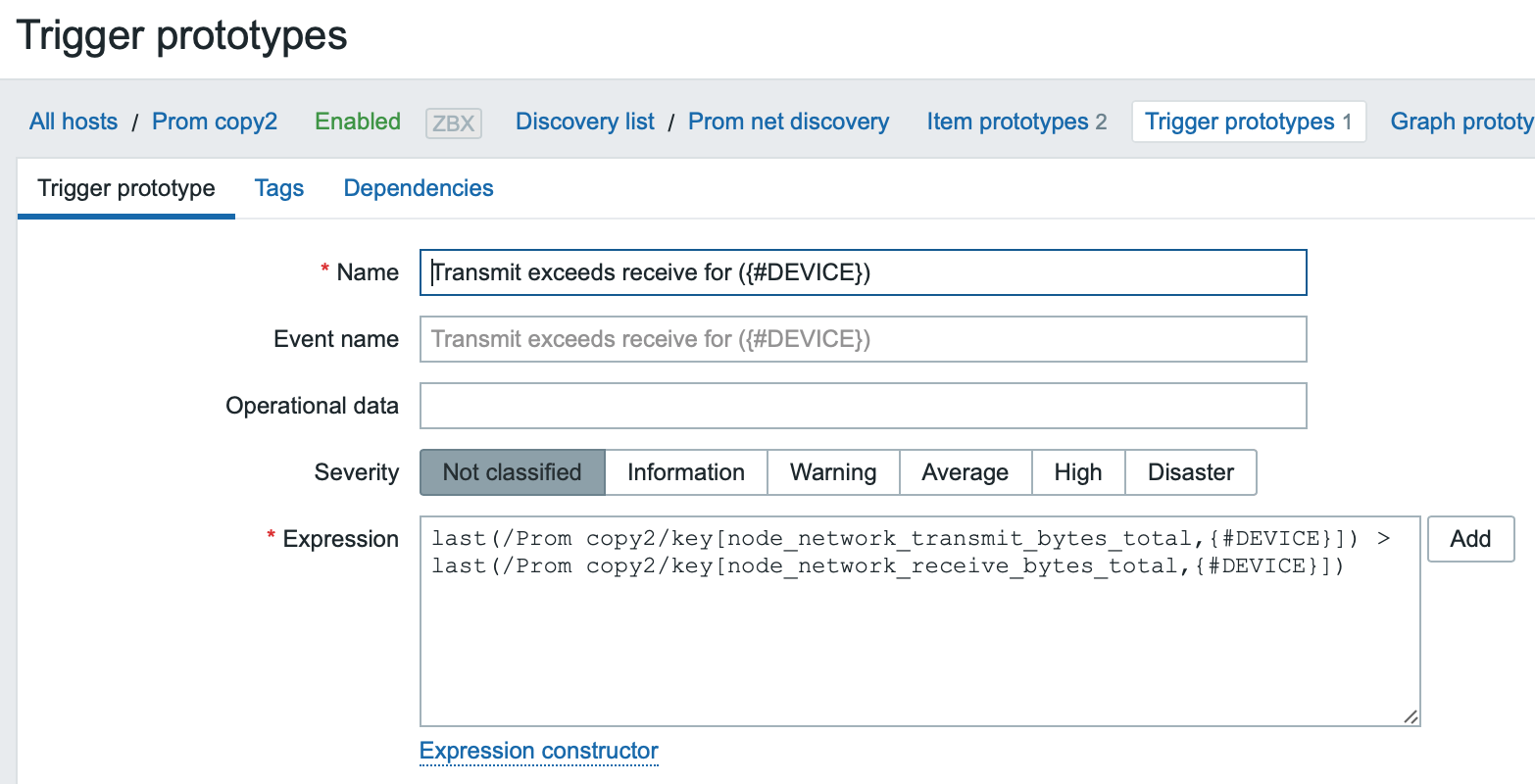

    3. Add one trigger prototype that refers to both items:

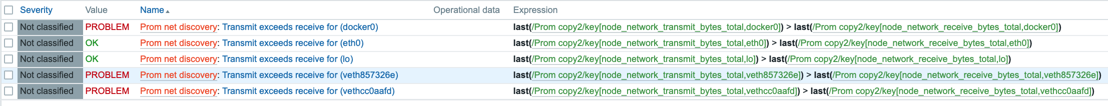

      4. Get the result:
