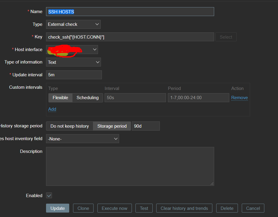

      Hi Atsushi, thanks for return.
      I created external scripts and is OK, but the Availability is not OK to HOST

      This is my external script, the host interface is x.x.x.x:0 (This scritpt is only test, I didn't monitor SSH port)
        What do you mean? Does that mean the ZBX icon doesn't turn green? The ZBX icon works only when monitoring with Zabbix agent.

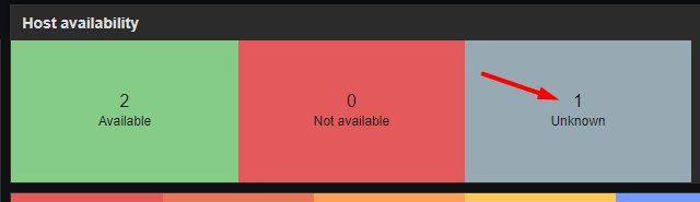

          I understood, but the host was unknown ... That´s my question , how monitoring hosts using script
