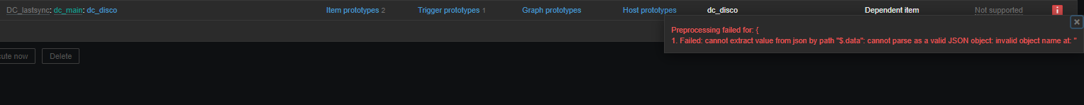

    Hello thanks, I have got that error, the same i had when i tried. :
    Preprocessing failed for: {
    1. Failed: cannot extract value from json by path "$.data": cannot parse as a valid JSON object: invalid object name at: ''
    Into last values i have only { showing.
    Maybe my json is not well generated (come from powershell script)

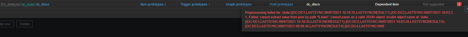

        hum maybe it does not work because it comes from a windows server because i did the same thing.
        Data are sent to the zabbix server but it seems that it could not read them.

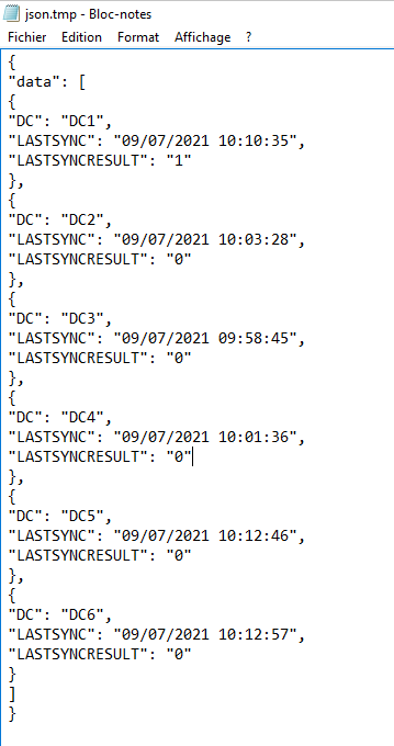

          That's strange because the file is really simple
          • HeadQuaker
            • Jul 2015
            • 58
            I have made it in one line, i have the same issue.
            Click image for larger version  Name:	48513.png Views:	0 Size:	26.2 KB ID:	431208

                Ok i have managed to make a readable json but now, it seems that the trigger is not working despite the fact the value is in error.
                • HeadQuaker
                  • Jul 2015
                  • 58
                  It's working really thanks to you
                  I've passed the json using the file directly thru the send.
                  I am understanding the process better now.
