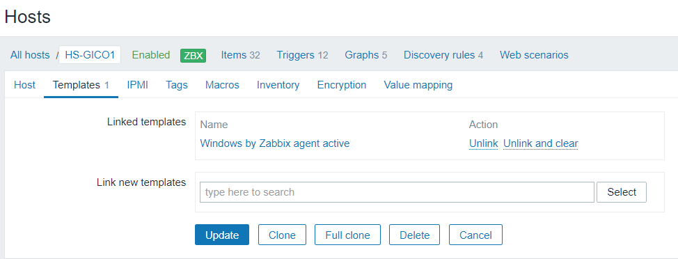

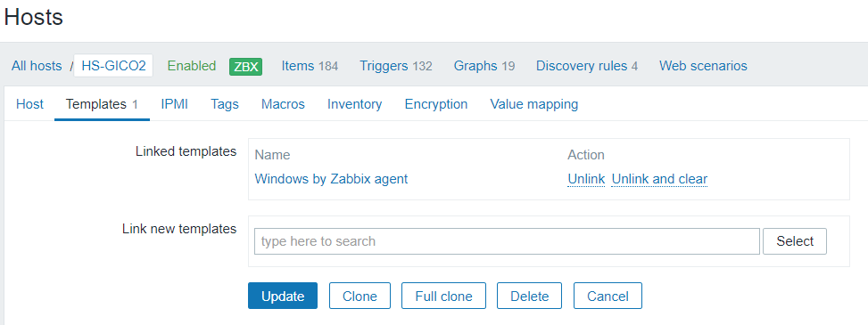

            Here are a couple of screen shots, both of these hosts are Windows Server 2019. With Active agent 32 items and 12 triggers, Passive agent is 184 items and 132 triggers.
            I would just use the passive and be happy, but I eventually want to monitor the firewall for changes, and when I googled how it stated I need to use the active agent.
            I downloaded the agent from the zabbix website and it is the same agent on both of these servers.
            If I try to add the both agents I get the error message below
            I couldn't figure out how to enable all of the checks that the passive agent is doing in the active agent.
            Active Agent
Name:	2021-09-10 11_11_57-vs-zabbix_ Configuration of hosts.png
            Passive Agent
Name:	2021-09-10 11_14_00-vs-zabbix_ Configuration of hosts.png

              I did the unlink and clear to switch from passive to active. Perhaps I need to unlink and clear, wait a bit and then link the active. Maybe I didn't give it enough time. I will try again on a different server and see what I get.
              • TecDragon
                • Nov 2019
                • 63
                Ok this appears to be my own lack of experience issue, I am learning through Youtube videos - so... The 'Zabbix Agent' is linked to 'Zabbix Agent Active' I thought these were two separate protocols and was trying to add them both in the 'Templates' section. After reading and re-reading the error message I thought I would go to both the 'Zabbix Agent and 'Zabbix Agent Active' and remove the double linked items, only to find out the double linked item is\was 'Zabbix Agent Active' itself.
                I appreciate your help and patience, talking it through helped me find the solution.
