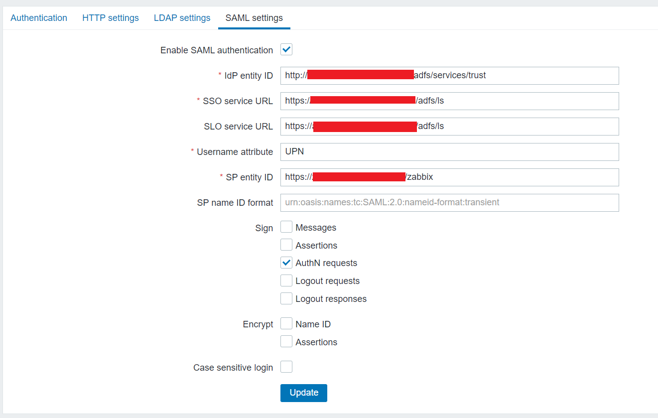

    I have been trying to set up Zabbix with ADFS for SSO. Despite my best efforts there is one issue I have not been able to get past. That would be that zabbix/ADFS will not accept anything I put in the "username attribute" field. This is how I have it set up currently:

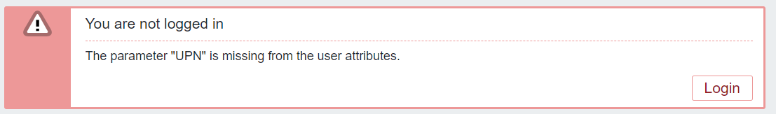

    However, no matter what I enter in the "username attribute" field, it simply will not work. I have tried UPN, UID, SAMAccountname, and more.

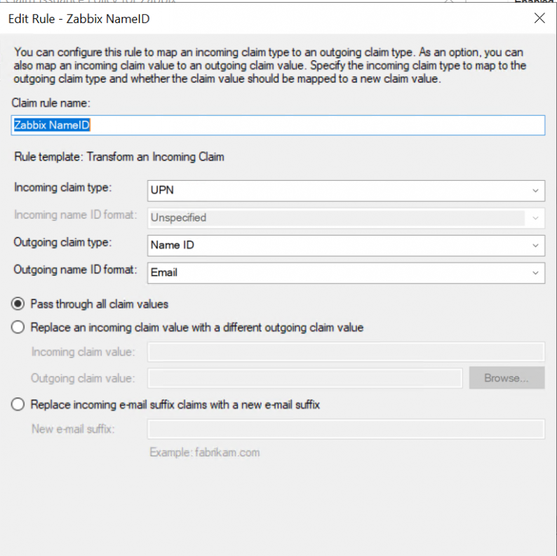

    This is what I have for a claim rule:
    Does anyone see anything incorrect or missing? Thanks in advance.

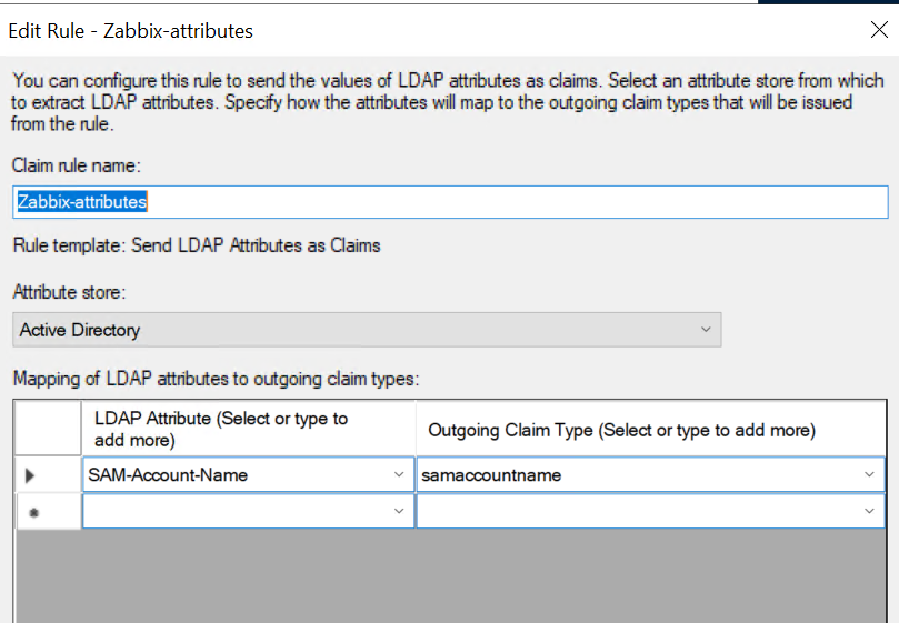

    I was able to get it to work. I made these issuance transform rules within the relay provider.
    Afterward I entered "samaccountname" as the Username attribute in Zabbix and was able to log in.
