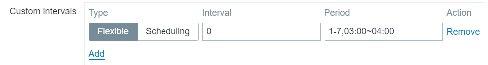

    Set the trigger occurrence time.
    There is a restart trigger among the Apache templates.
    There is an Apache restart at 03:30 every day, so we would like to modify the trigger not to be activated during that time.
    I applied it as a picture with Custom interval, but the trigger is still activated.
    How can I prevent triggers from being triggered for a certain period of time?Click image for larger version

    Flexible is correct set to 0. 1-7,03:00-4:00 replace ~ with - and should work, note that this has to be done on the item! nothing to do with triggers
