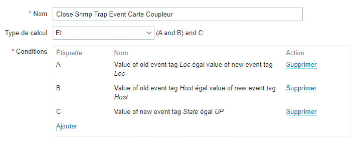

    I succeded by configuring the trigger and using event correlation like this :
Name:	event correlation.PNG
    "Loc" is a tag composed of the value of the item
    Thank you for your reply
