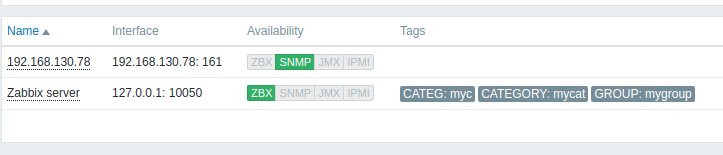

    Just to make it clear, I have the following:
    Click image for larger version  Name:	SkiPag4.jpg Views:	0 Size:	23.4 KB ID:	431758

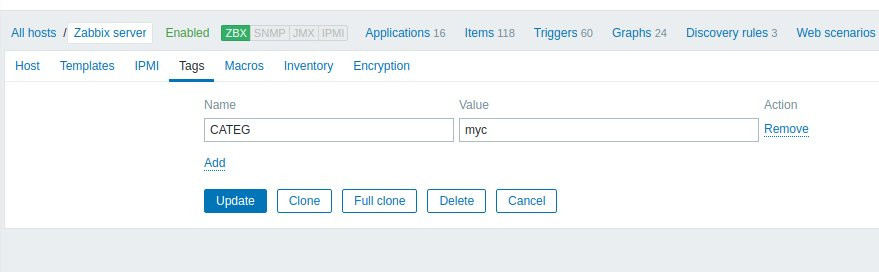

    In the host configuration I have this tag:
    Click image for larger version  Name:	SkiPag5.jpg Views:	0 Size:	40.3 KB ID:	431763

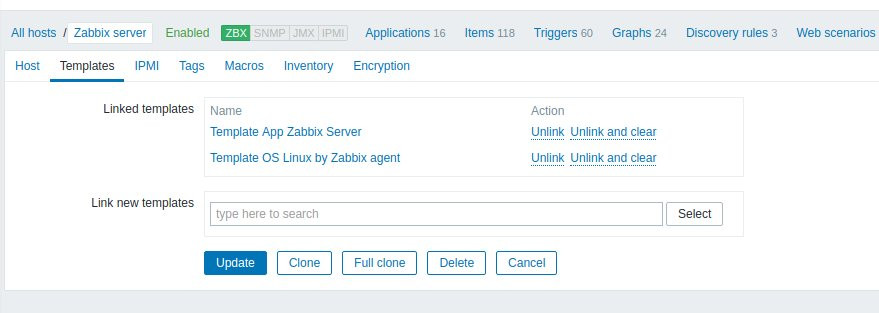

    This are the linked templates:
    Click image for larger version  Name:	SkiPag6.jpg Views:	0 Size:	53.1 KB ID:	431764

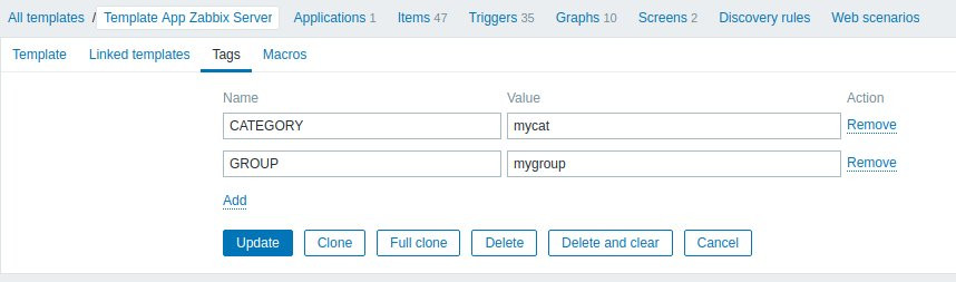

    and this are the tags in the linked template:
    Click image for larger version  Name:	SkiPag7.jpg Views:	1 Size:	44.0 KB ID:	431761
    I would like to have som ( or all ) of this tags in the mails I send for problems or error.
    Thanks in advance
    Pigi_102
