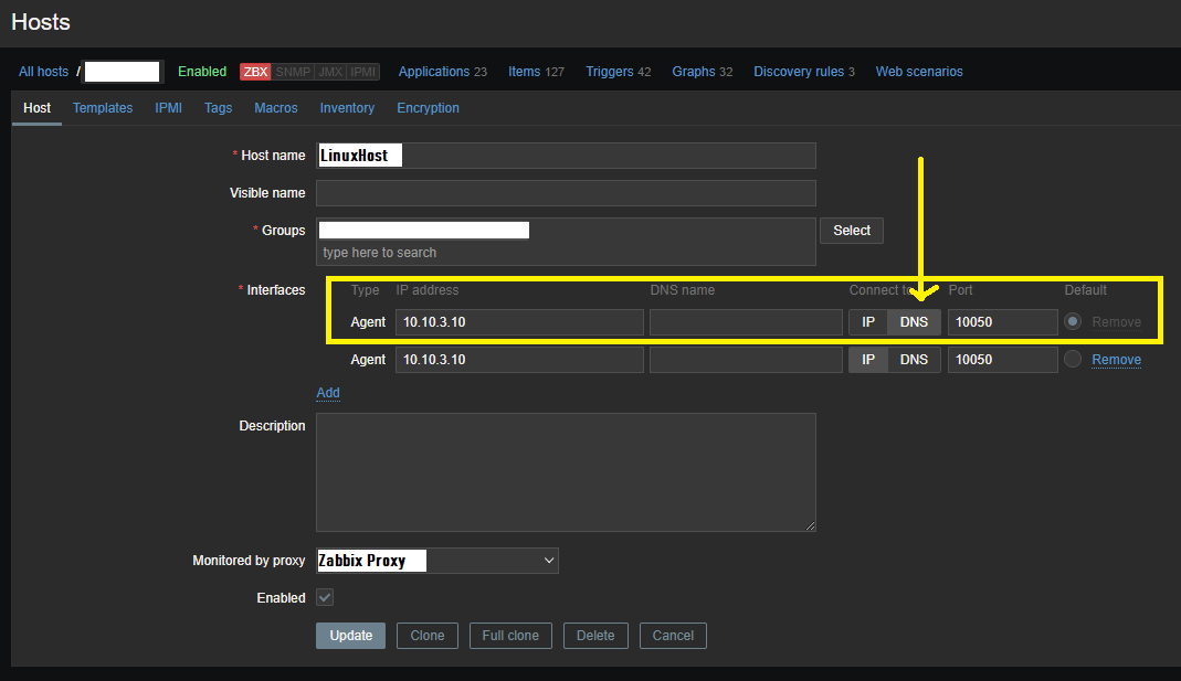

    After the auto registration, the DNS name is used for agent communication, as seen below:
    Click image for larger version  Name:	ZabbixCommunicationIssue.png Views:	0 Size:	40.5 KB ID:	432259
    Now you can guess the issue, the DNS name is not registered. It stays empty.
    I would like to not use DNS as the registration but IP instead.
    Now I can manually select IP address. then restart the proxy and the hosts is online.
    But the next day, it's 'wrong again' and configured to communicate with DNS instead of IP.

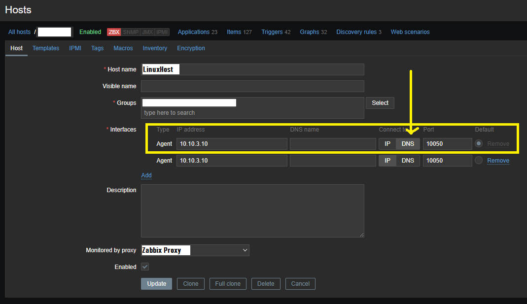

    this print screen shows the same issue, but different host and different proxy.
    So, it must be a global-configuration-issue
    Click image for larger version  Name:	ZabbixCommunicationIssue2.png Views:	0 Size:	31.4 KB ID:	432260

    by bad, I should have added that info to my original post.
    HostMetadata=10.10.3.10 in this case.
    Initially the host come online, and after a few minutes the device goes offline because it reverts back to "DNS" instead of "IP"

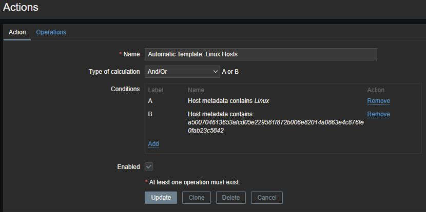

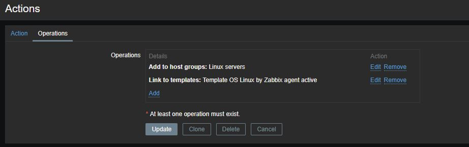

      And attached are 2 printscreens of the auto-registration configuration.
      Will this give you enough information?
