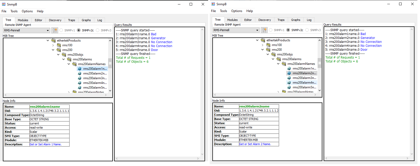

      normally, when I test it (using discovery OID: discovery[{#ALARMNAME},.1.3.6.1.4.1.21749.3.2.1.1.1]) I get
      [{"{#SNMPINDEX}":"0","{#ALARMNAME}":"Door"}]
      - for some reason, it is pulling the name from the 5th alarm.
      when trying with the discovery OID as the one you recommended: discovery[{#SNMPVALUE},.1.3.6.1.4.1.21749.3.2.1.1.1] I also get
      I did try discovery[{#SNMPVALUE},.1.3.6.1.4.1.21749.3.2.1.1.1.1] and I got
      [{"{#SNMPINDEX}":"0","{#SNMPVALUE}":"Bad"}]
      - which is correct as being the first alarm, but I would expect it to show me all 5 alarms when I run the discovery test.
      I have attached a picture that shows what the values are supposed to look like using SNMPB. ( I have confirmed this through standard snmpwalk as well)
      I do agree if I can get the index to be 1.0, 2.0, 3.0. etc, that would most likely work across the board for these devices. I just don't know how to tell it to do so.

        - can you plaese send picture/details with supgroup/childgroupe of "rms200alarms" I see only first two names of supgroupe.
        - every rms200alarmNname are same subkeys as name of group. 5x rms200alarm groups. That is interesting is that groupe "rms200alarm1name" has same count of subkeys as is count of all groupe on same level as "rms200alarm1name" ("rms200alarm1name","rms200alarm2name","rms200alar m3name""rms200alarm4name","rms200alarm5name") with INDEX "0"!!! I excpect .1, .2 (I describe what you writhe in your ask.)
        I think that is wrong implementation. You monitoring device has 5 sensors every with only one output value. (Bad, Generator, No Con, No Con, Door) Every with index "0". For me, for an incomprehensible reason, these values are repeated for all group names. I expect you to show me the same output on the output from alarm200 name 3, 4 and i 5. The same values the same indexes. That's why I think it's a bad SNMP implementation. Adding new HW extends the measurement only by the alarm200name6name group and the index value .0. Apparently something is cycled there and repeated. The question is whether a firmware upgrade or the current MIB or a question to support the manufacturer would not help.

          I can agree that this method of implementing SNMP seems to be a bad choice as well.
          I do have the MIB file from the vendor and have tried intermittently with the MIB Key names as opposed to numeric OID's. sadly no change there.

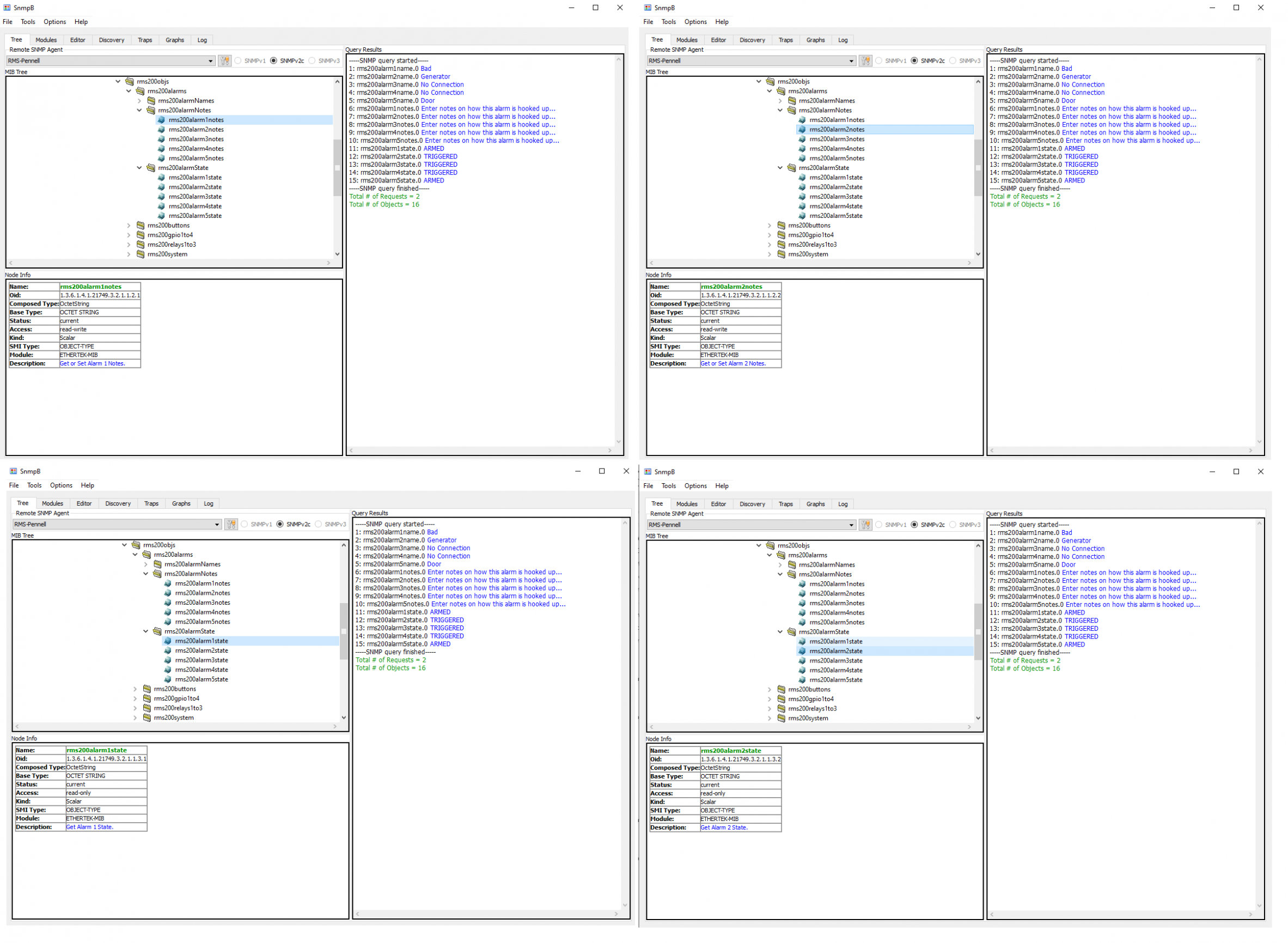

          I have added pictures of the other groups underneath rms200alarms
          I can definitely look into a firmware upgrade to see if they have fixed the .0 bit at the end.
          with preprocessing, I have not found a guide that helps me with either adding a .0 to the index or stripping it away. do you have any recommendations from that standpoint?
