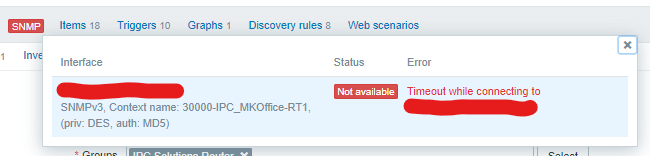

    I would like to use SNMPv3 to encrypt traffic from the router, however, I get the following when I attempt to connect:
    Click image for larger version  Name:	Screenshot 2021-09-30 083113.png Views:	0 Size:	19.3 KB ID:	432411

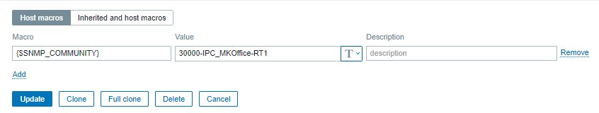

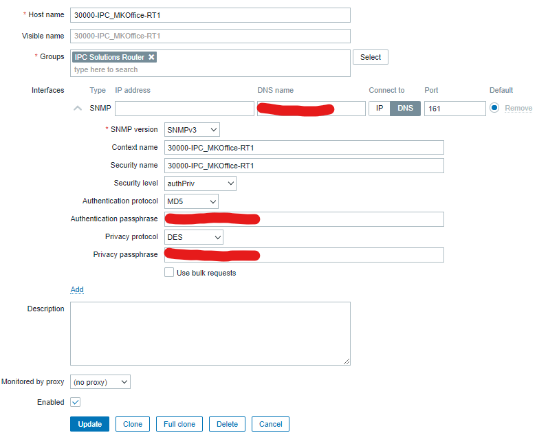

    This is what I have configured on Zabbix:
    Click image for larger version  Name:	Screenshot 2021-09-30 083142.png Views:	0 Size:	37.9 KB ID:	432412
    Click image for larger version  Name:	image_20161.png Views:	7 Size:	11.1 KB ID:	432415

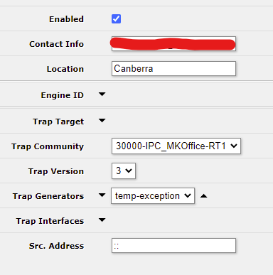

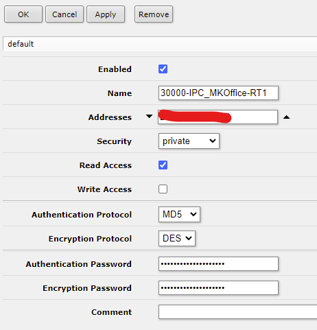

    And this is what I have configured on the Mikrotik router (I have checked that the Authentication passphrase and Privacy passphrase are correct):
    Click image for larger version  Name:	Screenshot 2021-09-30 083452.png Views:	0 Size:	21.2 KB ID:	432413Click image for larger version  Name:	Screenshot 2021-09-30 083523.png Views:	0 Size:	29.3 KB ID:	432414
