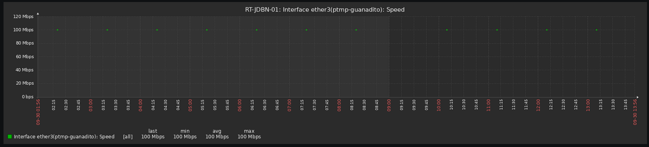

    For a week I have been trying to deal with a bug / error that I have with some triggers in zabbix and i currently use version 5.4.3. The error occurs that certain triggers are not closing automatically, I have been doing internal tests with a router on the network, and the triggers work perfectly, but there are some devices that the trigger does not close, and they have up to 16 days open. The template I use is the default Mikrotik SNMP Offsite, and the triger that does not close properly is the indicator of when an ethernet port changes speed, and when it returns to the normal value, the trigger is not closed.
    I have carried out the tests by changing the speed of some port in my local network from winbox using a mikrotik router, but in this case if this trigger is correctly activated and deactivated. Is there a known bug about this? I am attaching the expression of the currently discovered trigger, and together with that, a snapshot of the problem.
    change(/Interfaces SNMP Offsite/net.if.speed[ifHighSpeed.{#SNMPINDEX}])<0 and last(/Interfaces SNMP Offsite/net.if.speed[ifHighSpeed.{#SNMPINDEX}])>0

    And the recovery expression is:
    (change(/Interfaces SNMP Offsite/net.if.speed[ifHighSpeed.{#SNMPINDEX}])>0 and last(/Interfaces SNMP Offsite/net.if.speed[ifHighSpeed.{#SNMPINDEX}],#2)>0) or
    (last(/Interfaces SNMP Offsite/net.if.status[ifOperStatus.{#SNMPINDEX}])=2)

    And there is the capture for the graphs, the normal value is 100mbps.
Name:	Captura de pantalla-20210930135654-1293x293.png
