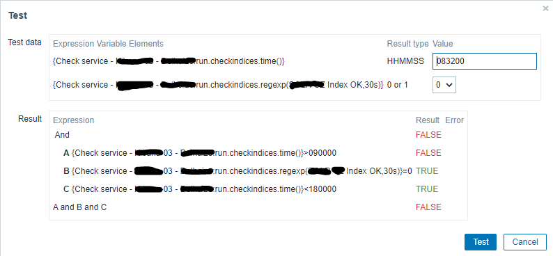

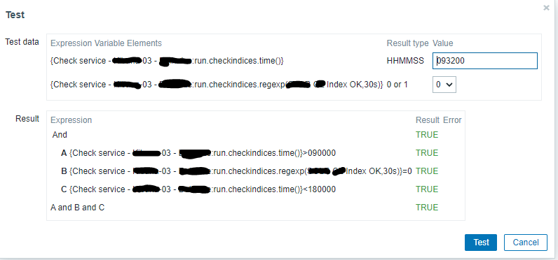

    I am having issues with making a trigger work between working hours only. My trigger is set as
    {Check service - MyServer-01 - Strike:run.checkindices.time()}>090000
    and
    {Check service - MyServer-03 - Strike:run.checkindices.regexp(My TEST Index OK,30s)}=0
    and
    {Check service - MyServer-03 - Strike:run.checkindices.time()}<180000
    Theoretically it works just fine as you can see in the test bellow but in reality it doesn't.
    Click image for larger version  Name:	perzabbix.PNG Views:	35 Size:	32.0 KB ID:	432845
    Click image for larger version  Name:	perzabbix2.PNG Views:	24 Size:	31.1 KB ID:	432846
    Right now it's 09:40(094000) and value from regex trigger is 0 but the trigger is not active. Could someone please help me understand what the issue might be?

    My bad, the issue was related to bad 'time'. Triggers are based on GMT(or at least in my case) while server's time is not GMT.
