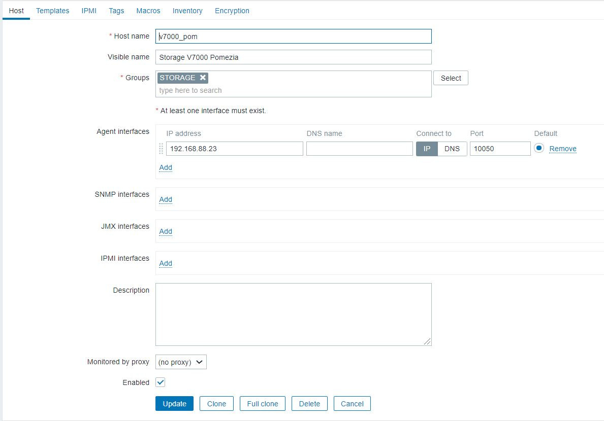

        Hi thiago, I have execute the your procedure for integrations ofi zabbix with V7000. I have configurated but I have any doubt:
        in the zabbix Gui, how must be configurated the interface? (in attach the my configuration).
