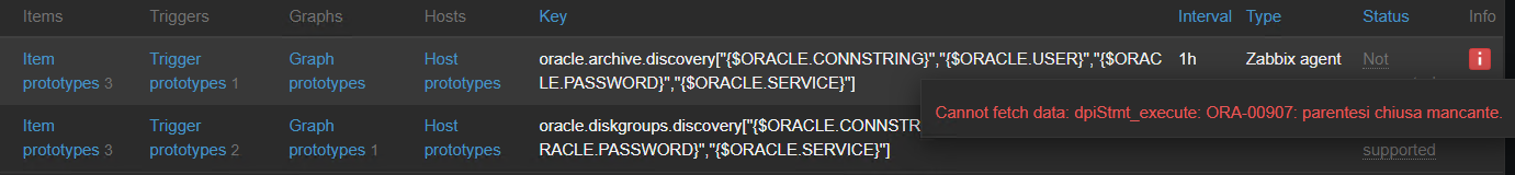

    I have to monitor an Oracle 12.1 installation and it seems that agent2 compiled with the Oracle plugin is unable to communicate with the Oracle server: the only thing that works is a function called oracle.ping and rightly returns '1' or 'ok' - All discovery functions return an error like 'dpiStmt_execute: ORA-00907 missing closing parenthesis'
    This appears to be a problem on version 12.1 - it seems that on version 12.2 it works fine. Has anyone been able to monitor an Oracle 12.1 installation?

    Here: https://www.zabbix.com/integrations/...#oracle_agent2
    is written:
    This template was tested on:
    * Oracle Database, version 12c2, 18c, 19c
    So, probably you need to use "old style" template (odbc or agent 1). You can find some on the same page under "Template DB Oracle By ODBC" and "3rd Party Solutions" links.

      I have follow your suggest: now work..
