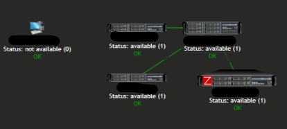

Changing host "status" over the map
  • galavichid
    • Mar 2021
    • 45
    I'm wondering if there is a way to remove the "OK" under each host as it showing the wrong status.
    And maybe changing the 'not available (0)' \ available (1) to something shorter with maybe red\green color?
    This is the only way i've found to show the real status of the hosts:
    {HOST.NAME}
    Status: {{HOST.HOST}:zabbix[host,agent,available].last()}
    Happy to hear if some have better idea \ solution for the above.
