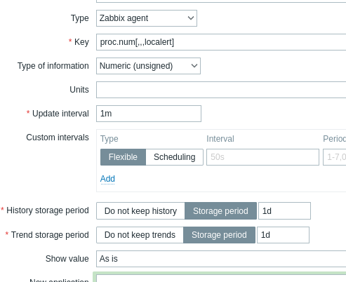

    I have an item that should monitor some proccess.
    When I test this on monitored server I'm seeng a correct result
    HTML Code:
    zabbix_agentd -t proc.num[,,,localert]
    proc.num[,,,localert]      [u|2]
    But when I check it on Zabbix Dashboard it is getting 0.

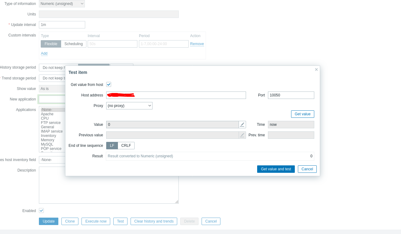

      But when I'm checking it via Zabbix Dashboard I'm getting 0
