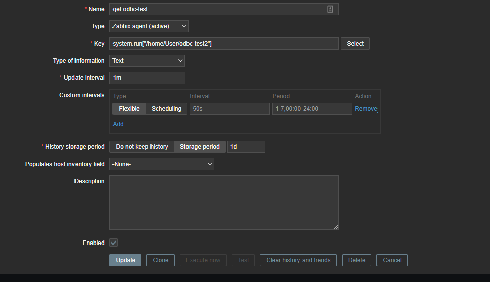

    the Item configuration is:
    Name - get odbc-test
    Type - Zabbix agent
    Key - system.run[python /home/User/odbc-test3]
    Interface - 127.0.01
    Intervall 5s

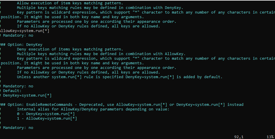

    Ive configured the /etc/zabbix/zabbix_agend.conf with
    AllowKey:system.run[*]
    altough it says
    #       If no AllowKey or DenyKey rules defined, all keys are allowed.
    but i still get the information unsupported item Key.

    make sure you have an '=' and not a ':' in your configuration file (AllowKey=system.run[*]) and everything in your system.run should be enclosed in quotation marks (system.run["python /home/User/odbc-test3"]) with a zabbix or zabbix active agent

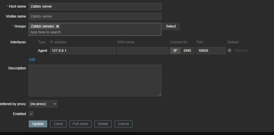

ID:	433771 Click image for larger version
ID:	433772 yes my bad, its AllowKey=system.run[*]! ive used that video for trainingspurpose: https://www.youtube.com/watch?v=Oha53b00vR0

        Found the answer:
        I had to add EnableRemoteCommands=1 even it is depricated.
        wow i didn't expect this to be the reason it was not working...
        • Oz_Joris
          • Sep 2021
          • 19
          Which version of Zabbix are you using? On 5.0+ it seems that EnableRemoteCommands=1 is replaced by AllowKey=system.run[*] right
