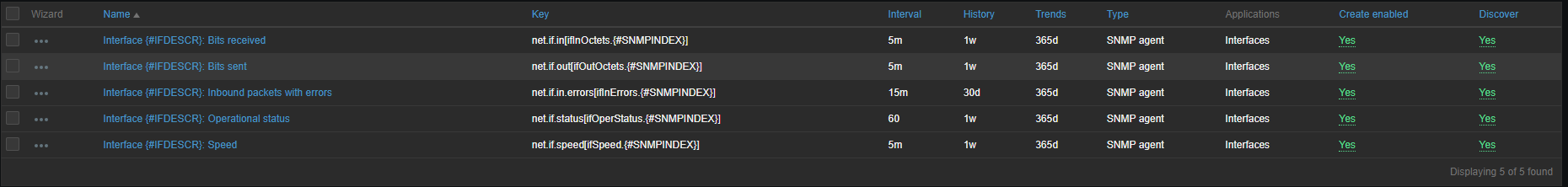

    so we are running some Cisco switches (sg350x-48p), where port security is configured and we would like to monitor if someone caused a port violation. We already do have a existing template but would like to add these OIDs
    portAdditionalOperStatus 1.3.6.1.4.1.9.5.1.4.1.1.23
    or
    cpsIfPortSecurityStatus 1.3.6.1.4.1.9.9.315.1.2.1.1.2
    to the Item prototypes but i've got no idea how. Do I have to create a new discovery list or edit an existing one? Iam fairly new to this topic and on how the discoverylist exactly works and if the key always need to be a specific one. I couldnt find any clues on the internet on how i could get these SNMP OIDs

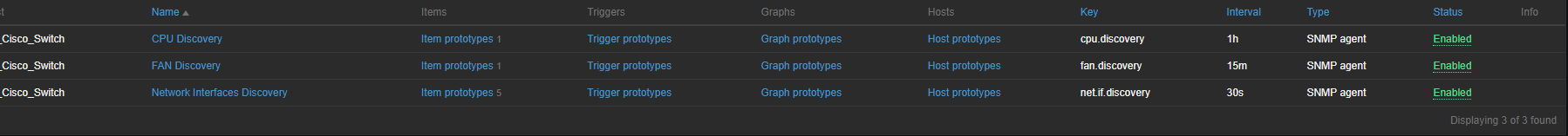

    Discovery List:
    Network interfaces Discovery:
    Item Prototypes:

      Just add new item prototypes under same discovery.
      For example you can go with following for port Additional Operational Status: key like net.if.adStatus[portAdditionalOperStatus.{#SNMPINDEX}], making sure to set data type corresponding to data that is actually returned(not sure data type for said OID. Can start with string and see what is actually returned).
