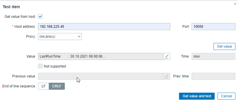

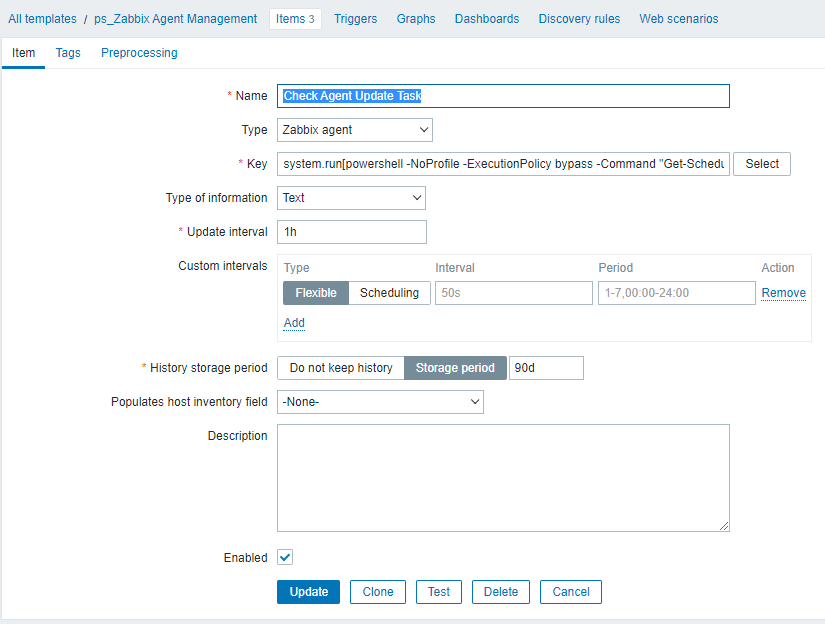

    I created a windows tasks, that I want to monitor. The easiest (for me) would be to issue a Powershell command through a custom item and process the given output. The Powershell-command itself is quite simple:
    Powershell -NoProfile -ExecutionPolicy bypass -Command "Get-ScheduledTaskInfo -TaskName 'Zabbix-Agent - Deploy Data'"
    The Item in Zabbix is this right now:

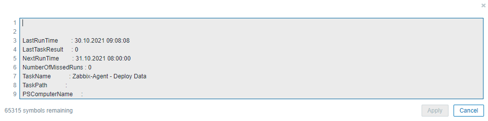

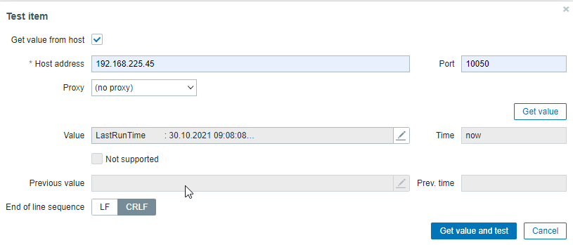

    Test is successful:

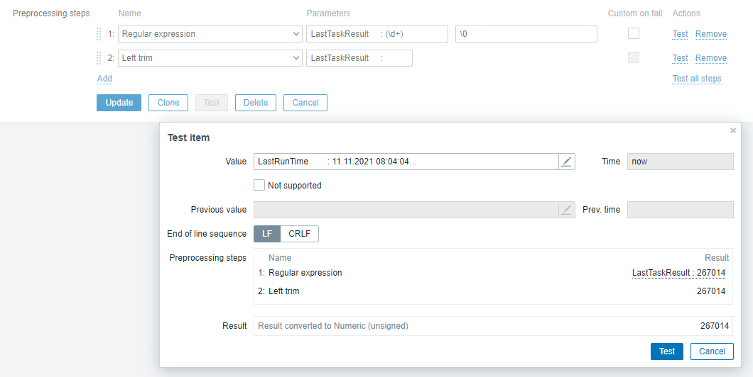

    Right now I’m interested in the Value “LastTaskResult”, but want to build up on that and monitor other items too (like “NumberOfMissedRuns”, “LastRunTime”, “NextRunTime” etc):

    Hey there!
    You can create dependent items! (a bit more about them here https://www.zabbix.com/documentation...ependent_items)

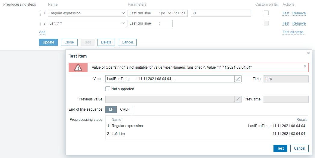

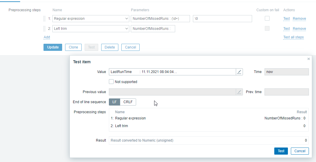

    So here is what you can do: with one item, you collect the entire block of information, the entire result of your command, and from that, you create dependent items (it's an item type, like zabbix agent, ssh agent, etc.) which is going to reference this first item with the information block, and using the preprocessing tab, you're going to use regex to get LastTaskResult, LastRunTime and everything you need.
    This site can help you with the regex https://regex101.com/ (Play it around here and than test it in zabbix)

      Thank a Lot! I´ve read through your post and the linked pages. That was exactly what I needed.

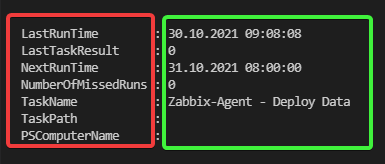

      The Powershell-Output is:
      LastRunTime : 11.11.2021 08:04:04
      LastTaskResult : 267014
      NextRunTime : 12.11.2021 08:00:00
      NumberOfMissedRuns : 0
      TaskName : Zabbix-Agent - Deploy Data
      TaskPath :
      PSComputerName :
      With regex I selet the Value behind Title "LastRunTime", "LastTaskResult", "NumberOfMissedRuns" (see the attached pictures.
      And get the digit ouput. Now I only need to format "LastRuntime" into a date-format and tell zabbix that everything above Zero from "NumberOfMissedRuns" should throw a warning
